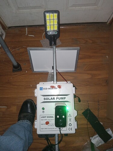

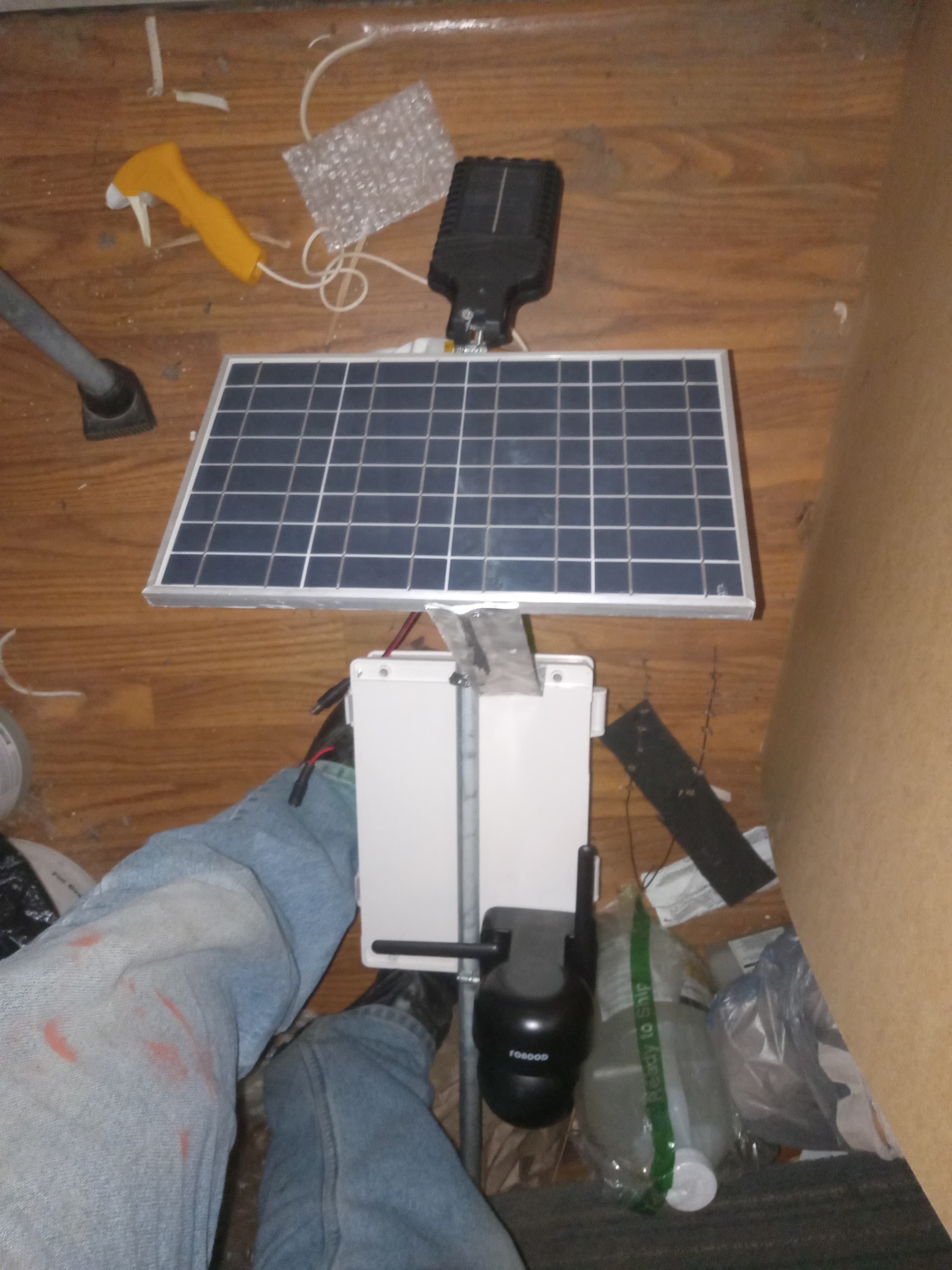

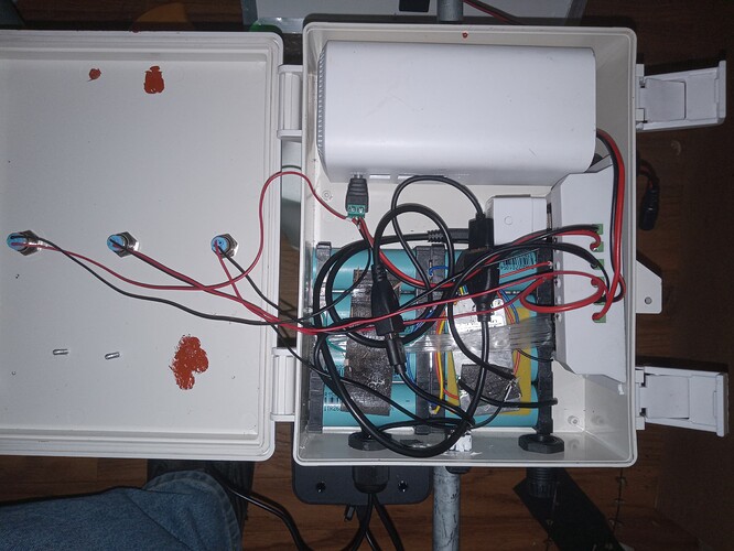

So, my 18v 35w solar panel feeds my 12v 20a solar controller (it provides power for mesh router and usb plug zigbee repeater), 10a bms with 8ah lithium battery, usb power outlet (sonoff with built in repeater), a wifi mesh router, 2 cameras (one pointed fixed and another ptz facing the other way, a self contained motion solar light mounted to the pole.
All this is mounted in a outdoor box originally made for a solar water pump. The box had 8ah lithium battery with a 10a bms, 3 leds, a switch, 2 cord grips, and a controller board. I tried to use the well pump solar controller but the parameters built into it, are not conducive to this particular situation. I programmed my solar controller to 14.6v max cutoff, 11.7 re-power output, and 11.4 cutout voltage. My lithium battery likes this setup so far. I would have used lifepo4 but the battery that came in the box is a lithium-ion battery with bms, so I left it in there.

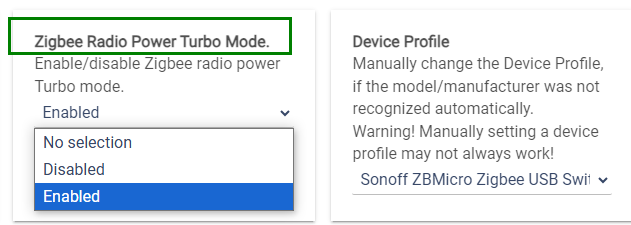

You can also try configuring the ZBMicro in 'Power Turbo Mode' :
Ok, I used the tuya zigbee switch and with the sonoff zbmicro device, and it is working great.
I will keep in mind the other driver for future reference.
Btw, what would power mode do for me or is it something kin to sliced bread? Hehehe
