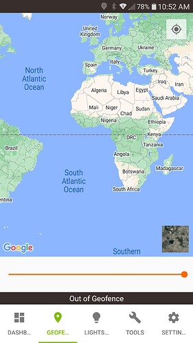

Notice that the V20 (android v8) presence shows as away. Herein is the problem, it's not away. The V20 is logged in as a guest and I created a device for it. The problem is, the geofence is just not there. When I open the geofence tab in the mobile app on the V20, I get a world overview, it doesn't zoom in because there's no geofence.

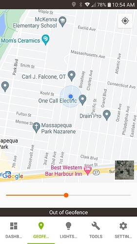

If I hit the target button to zoom in on the phones location, it zooms in as expected.
But there's no geofence showing anywhere.
I looked through the documentation but there's not much useful for troubleshooting a problem like this. Any suggestions, solutions or ideas?

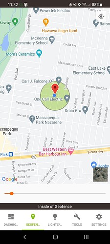

Thanks for the response. I had already done both the lat/lon and time zone check. Took me a few minutes to figure out you have to delete the zip code before it takes a lat/lon. It's sitting right on top of my house in the map, Here's the geofence tab on my Samsung S21+ (android 13).
