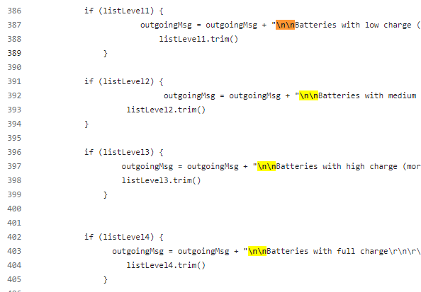

You have double \n\n in a couple places without the \r
Thanks well spotted. that fixed it..
I just a ctrl-f search \n and looked at every one to make sure it had a \r before it, eventually found that cluster.
