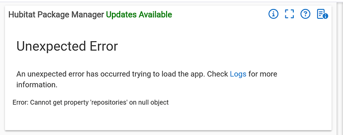

Have problem starting Package Manager. Get this message.

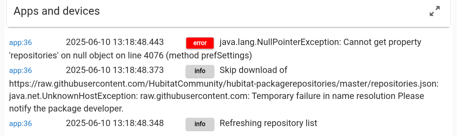

And this is the log file.
I might be tempted to Remove the app and then reinstall....
Can you ping 'raw.githubusercontent.com'? That's the underlying error ("Temporary failure in name resolution").
Thanks, having intermittent Wi-Fi issues. Have to get that fixed first.
That could also account for the error you're receiving from HPM as it needs to reach out to Github.
That was the problem. Resolved the WiFi issue and HPM is fine.
