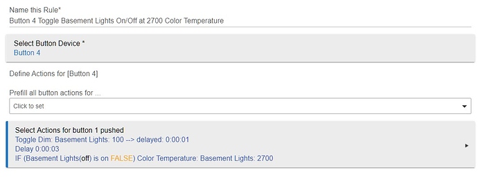

I was trying to set up an Iris Smart Button 3460-L to toggle a group of EcoSmart CT bulbs on and off if pushed at CT 2700 and, if held, to toggle on and off at CT 5000. I found that I needed to insert a delay between the on/off toggle and the CT adjust command. It is important NOT to enter an explicit dimmer value in the CT set command. Just leave it empty, A 3-second delay was the minimum the bulbs needed to be on to recognizing the command to change the CT. Here's the On/Off Toggle if Pushed for CT 2700 rule.
Of course, the 3-second delay is only apparent if changing color temperature modes. If toggling on/off in the same CT mode, the change command is issued after the toggle to "on", but makes no visible change to the bulb. The 1 second delay to the initial toggle command is used to address an unrelated issue.
