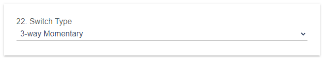

You'll want to make sure you change parameter 22 to a 3-way momentary switch in the driver.
Ah, thank you so much. Works like a charm. Notice now though that when turning the switch back on, they don't return to their previous dim level, but rather full on (even when not operating the add-on). Is that a limitation of using an add-on or do I just need to tweak settings again?
