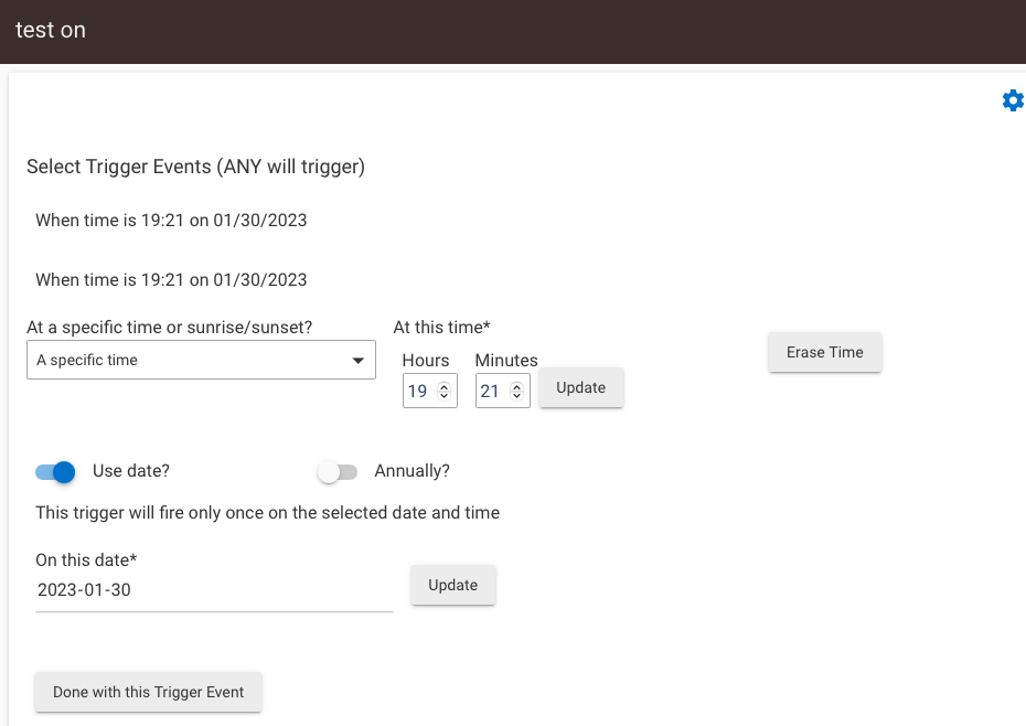

I'm trying to do something very basic to set a switch on at a specific time on a specific day.
when I test my rule not using a date just setting a time it turns on with no problem. when I set a specific date the action does not run...

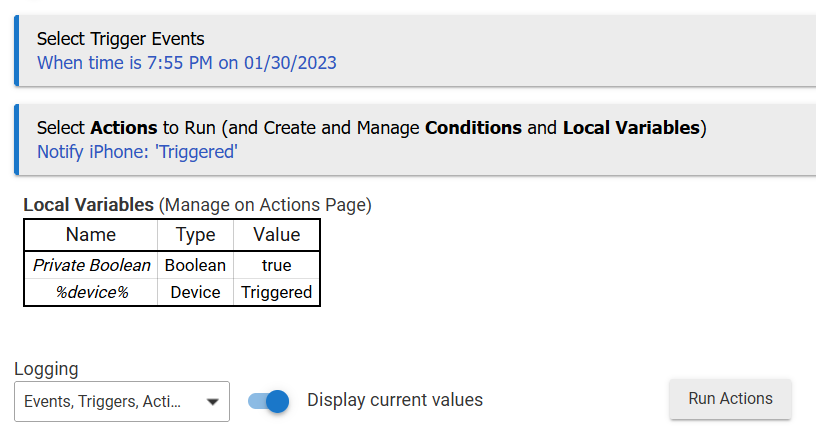

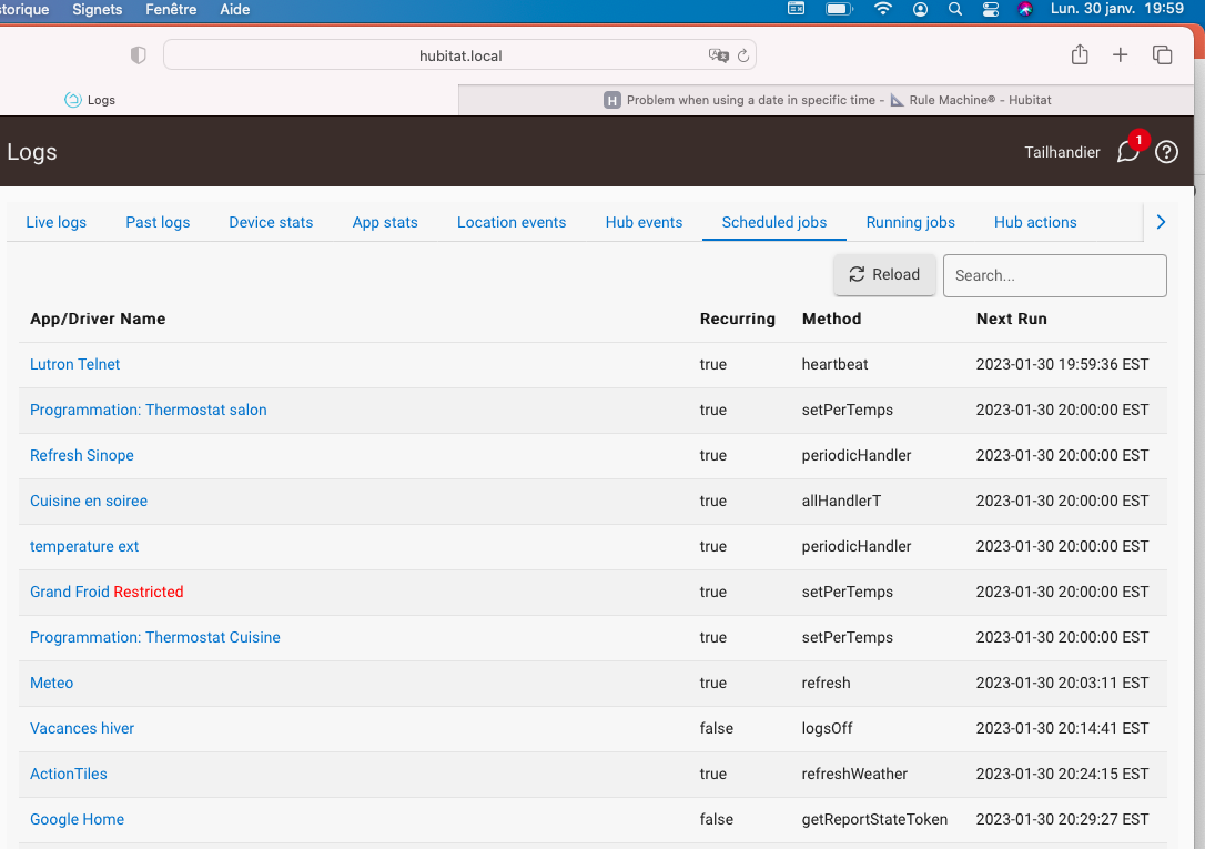

Can you update it to about 5 minutes from when you read this and let me know if there is a scheduled job?
This worked for me on version 2.3.4.137

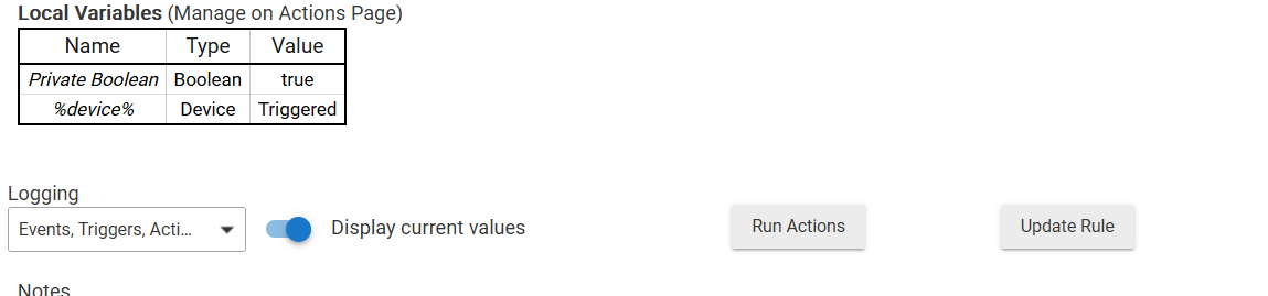

Did you select the Update Rule or Done on the main rule page? Just updating the trigger won't actually schedule the trigger.
