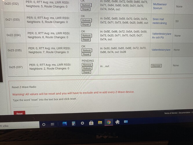

Yes I have done a z-wave exclusion and pressed the program button to reset the device. The diode flashes but then nothing happens. I have also done a repair z-wave and a Reset Z-Wave Radio without success. Rebooted the Hubitat and tried to add the device again but it is not added anyway. This is the first z-wave device I am trying to connect. My other zigbee units work without problems. And yes I am from sweden

Did you make it work Lars? I have the same problem as you had. At first, it was discovered but never paired. And now I cant exclude or include it. It still includes and excludes on my old Vera tough so it's not broken.
