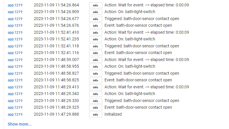

Terrible. I performed a soft reset and after restoring the settings, the 'wait for event->elapsed time' and delayed actions stopped working. I updated to 2.3.6.145. It didn't help, all the above problems remained, 'wait for event->elapsed time' still didn't work (I made a simple rule to illustrate it). I returned to the 2.3.5.146 version and restored the previous database - now it is stable, but still with the old version.
