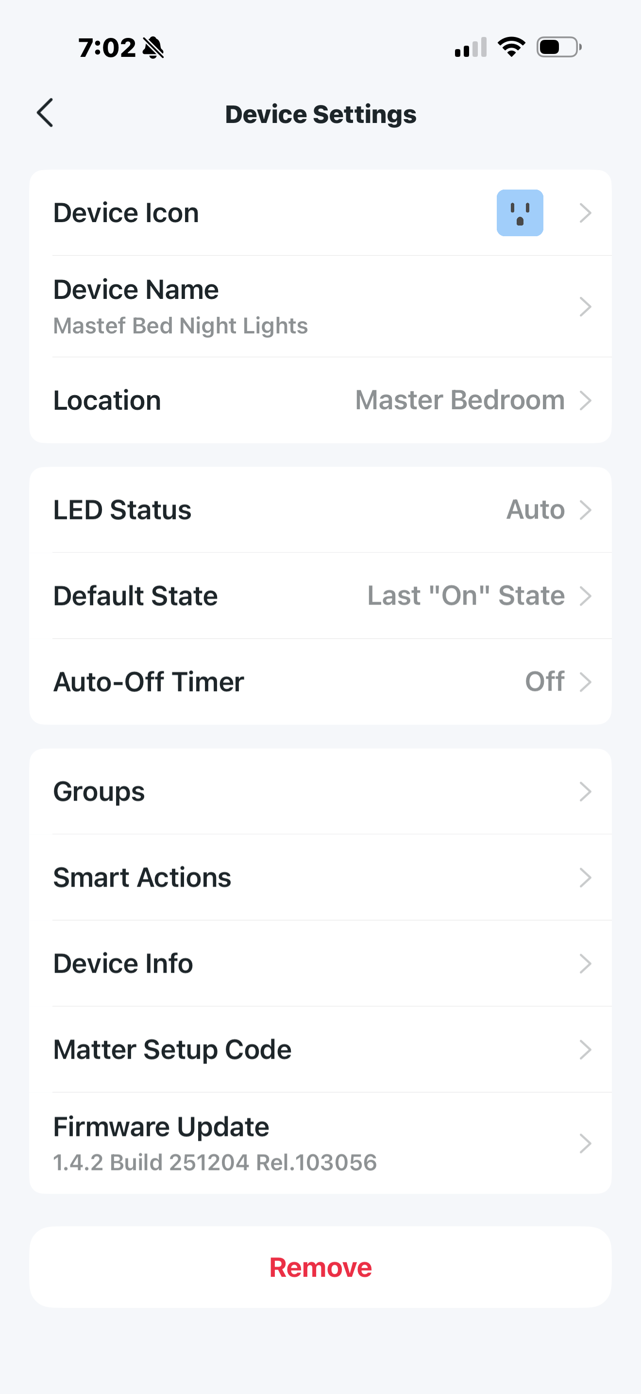

Install in the Tapo phone app first. That will assure the device firmware is up to date.

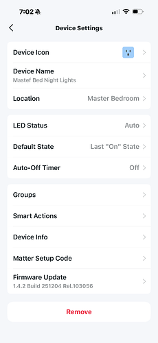

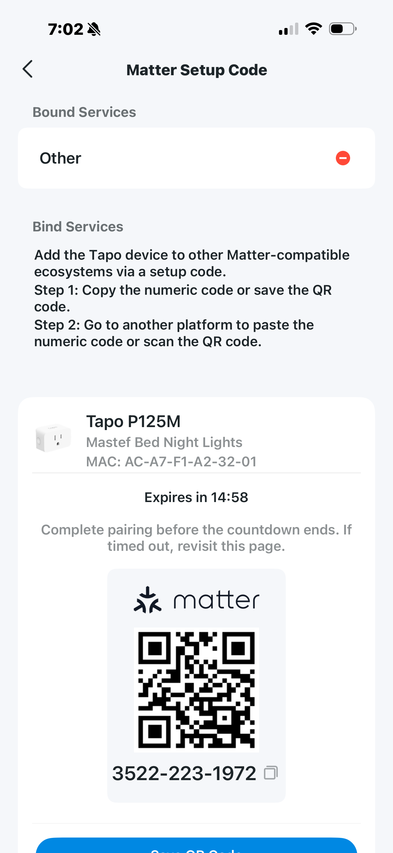

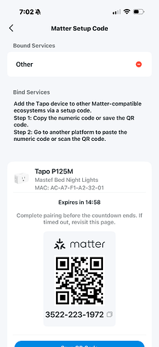

Within the setting for each Device is a parameter: Matter Setup Code. Press that. That is the code to use for Hubitat Installation.

I got the matter code from my Tapco app on my phone.

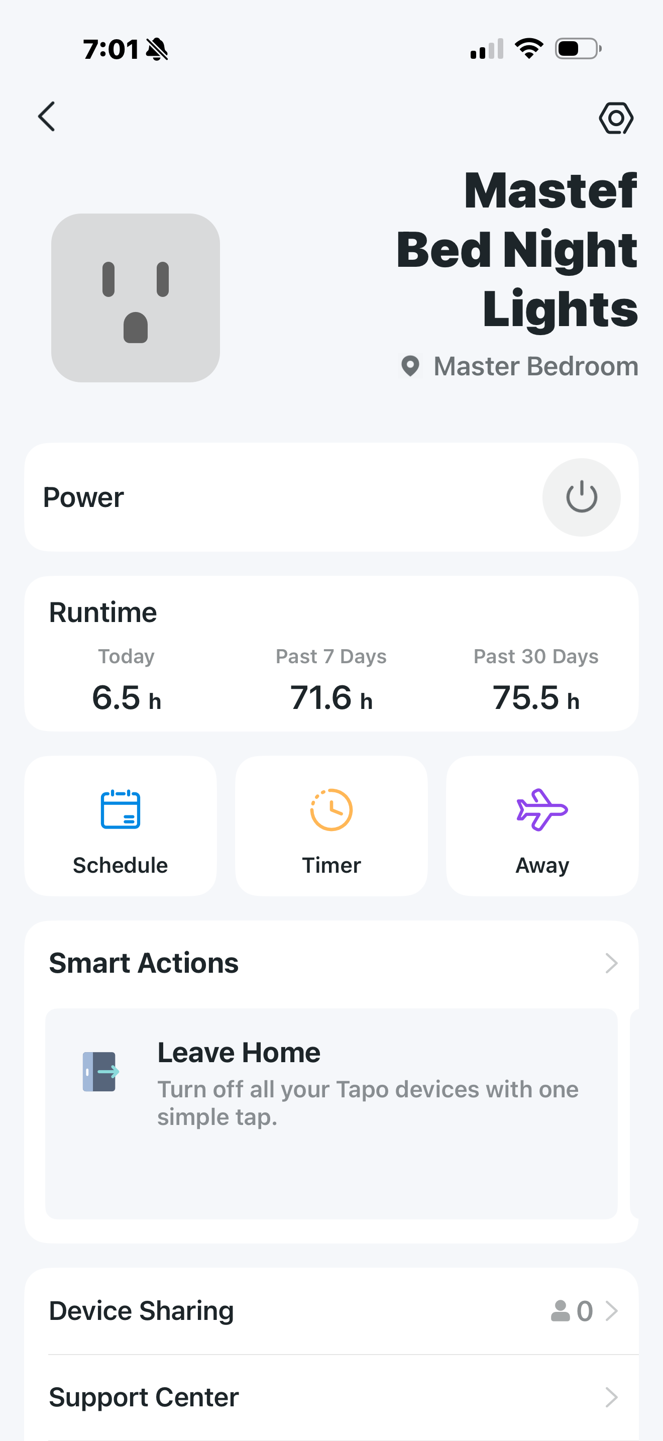

This is the one that is currently working perfectly. After I enrolled it into the app I then got the matter code and put it into the Hubitat hub
By the way I have no problem at all putting the devices into the Tapco app & updating the firmware.

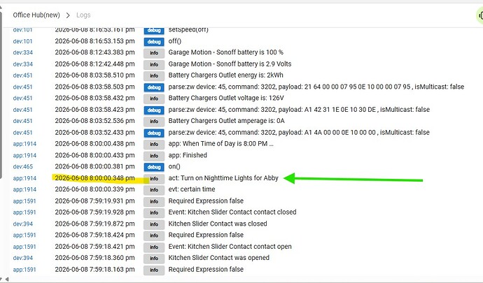

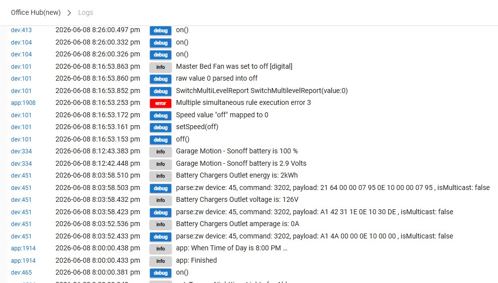

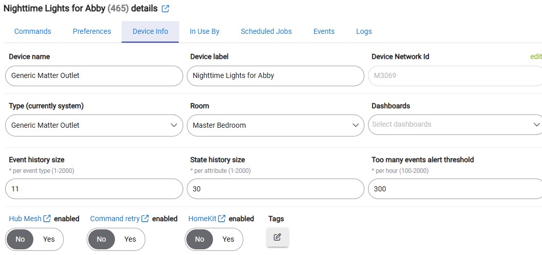

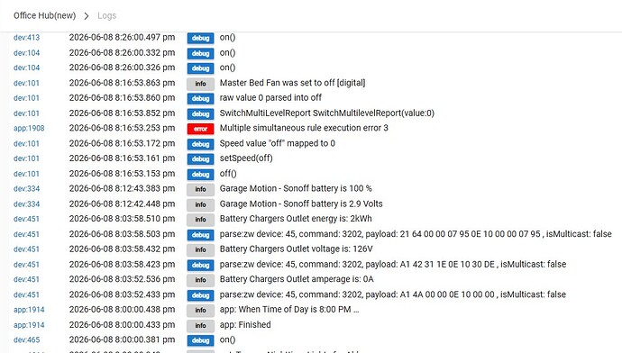

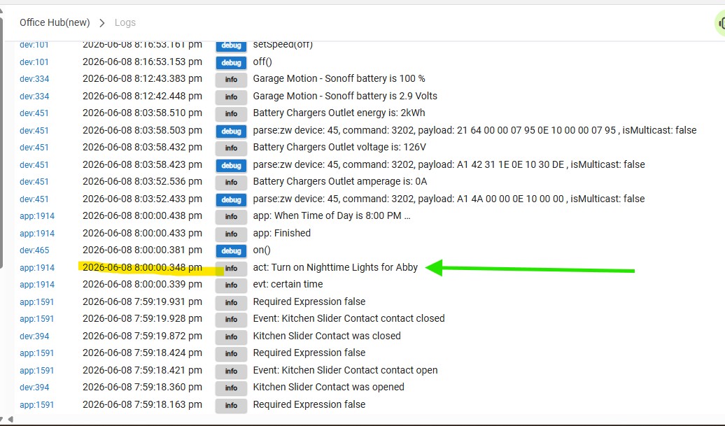

For the first time this outlet did not turn on at 8:00 pm - always did before. What is going on??
The log displays that the lights turned on however the outlet never fired, it in fact never turned on.
How I installed each device is with my phone and the Tapco app. After powering up the device I enroll it into the Tapco app once it is there I go to my computer and retreive the Matter Setup Code and enter it into the Hubitat hub under of course device → matter → enter 11 digit code

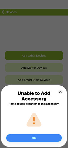

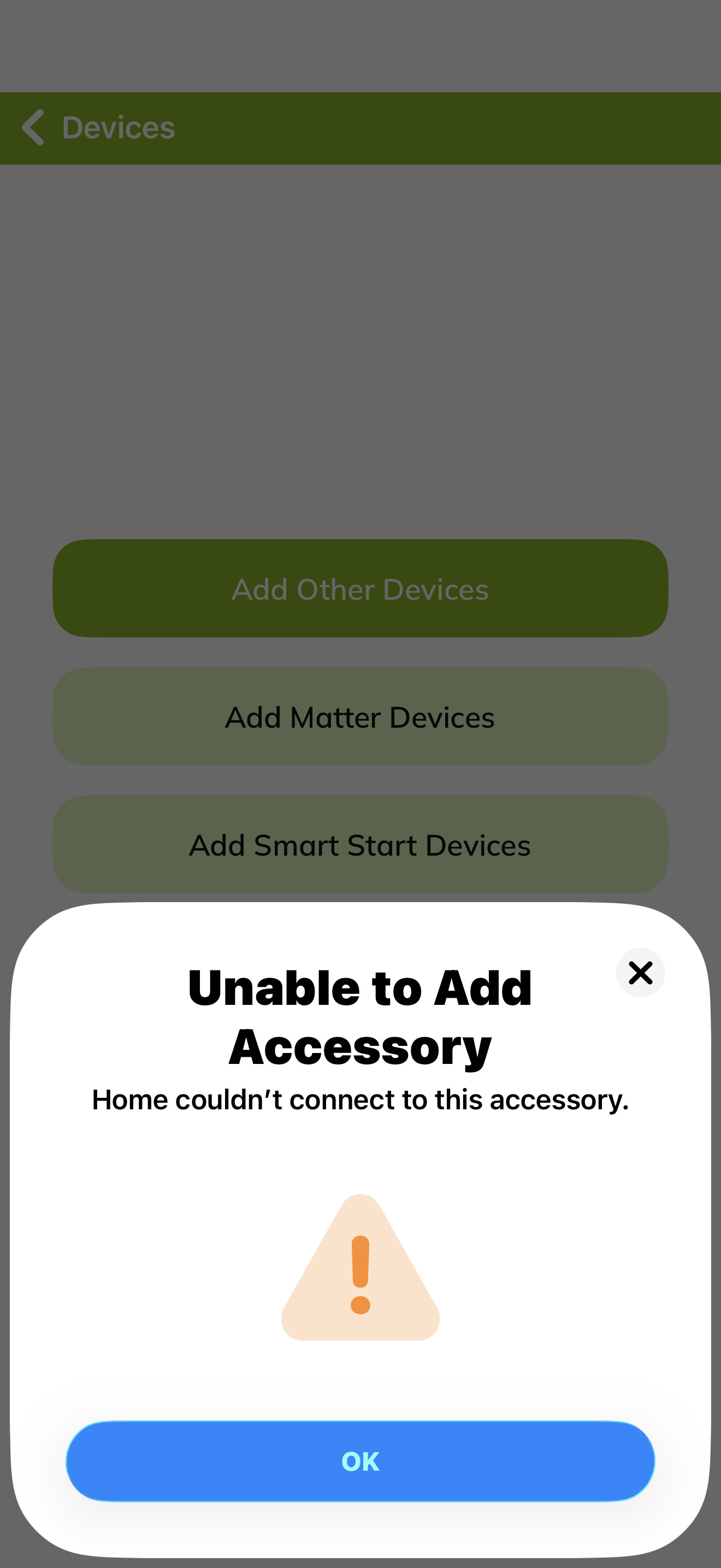

  • Tried installing again without removing the successful install (to see what happens). Failed with message:image

  • Tried install again without removing successful install and the phone app just hung (I never saw the screen in your message)

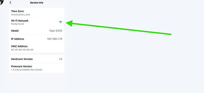

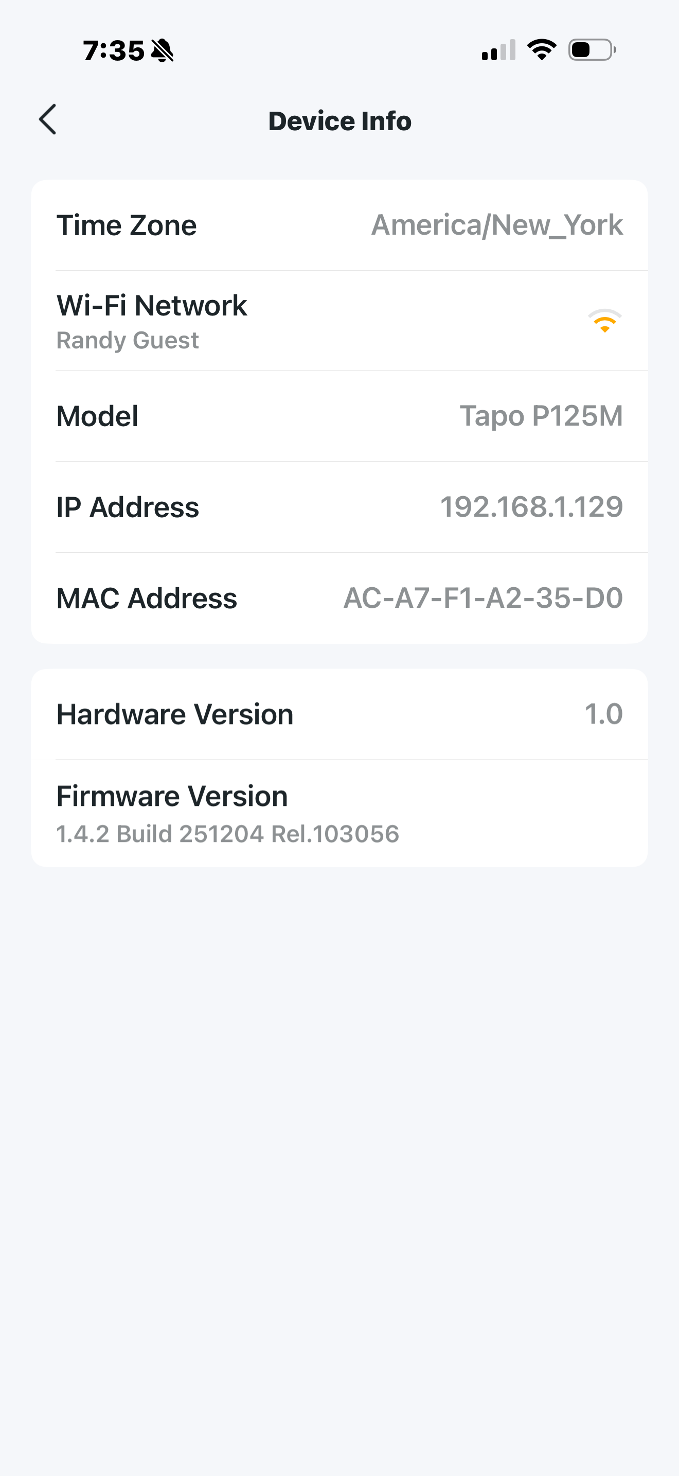

  • Tapo phone App: Go to settings > Device Info on the three plugs. two checks: how many bars and wi-fi network (network should be the same for all devices). (mine currently has a single yellow bar - but works ok). If not, reinstall the two devices to the same wifi network as your working device.

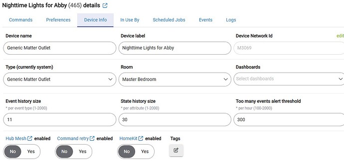

  • Devices: Sort by “Type” and scroll down to the “Generic Matter Outlets”. Are there any unexpected devices here? If not, good. If so, resolve but make sure you do not delete something you are actually using. (sometime phantoms exist).

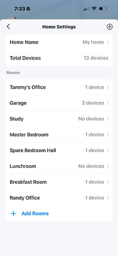

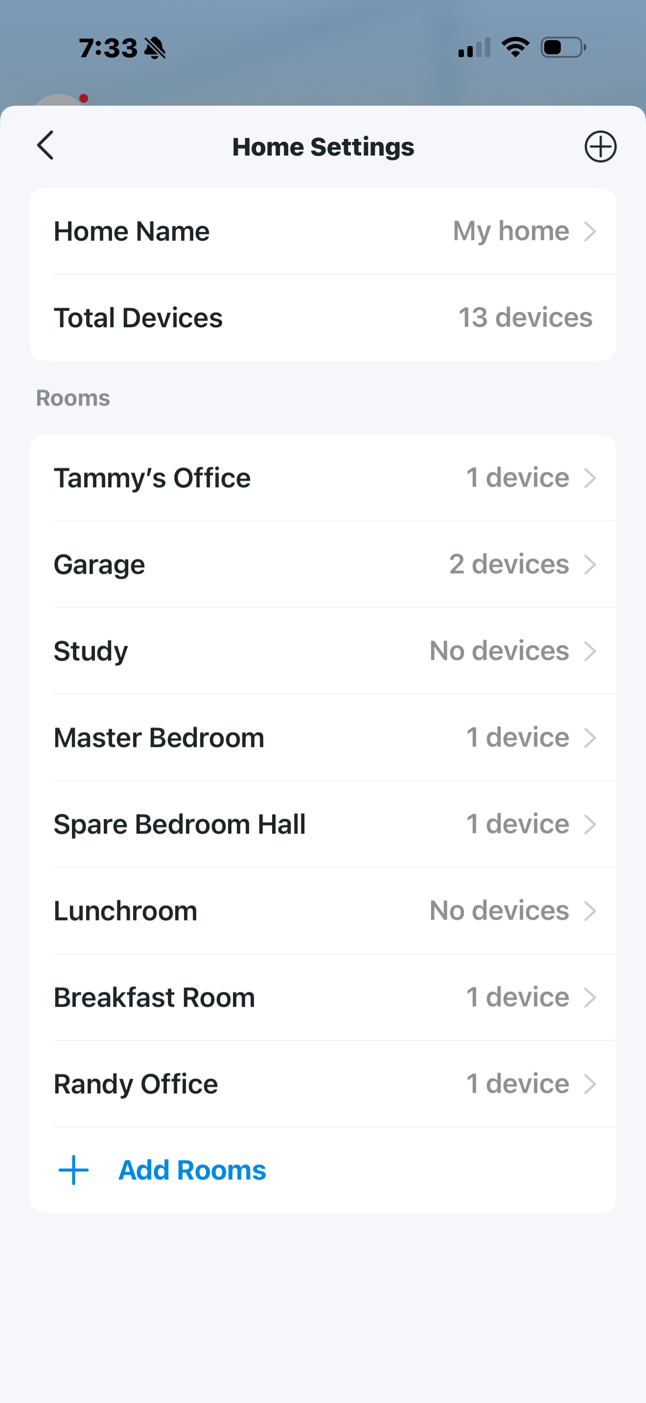

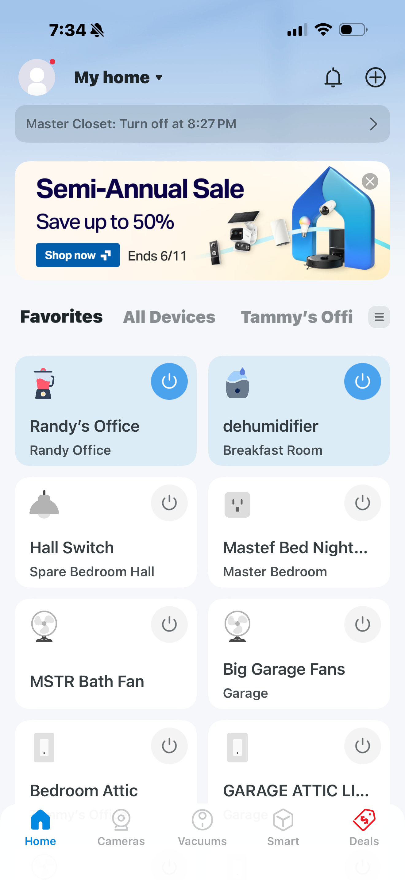

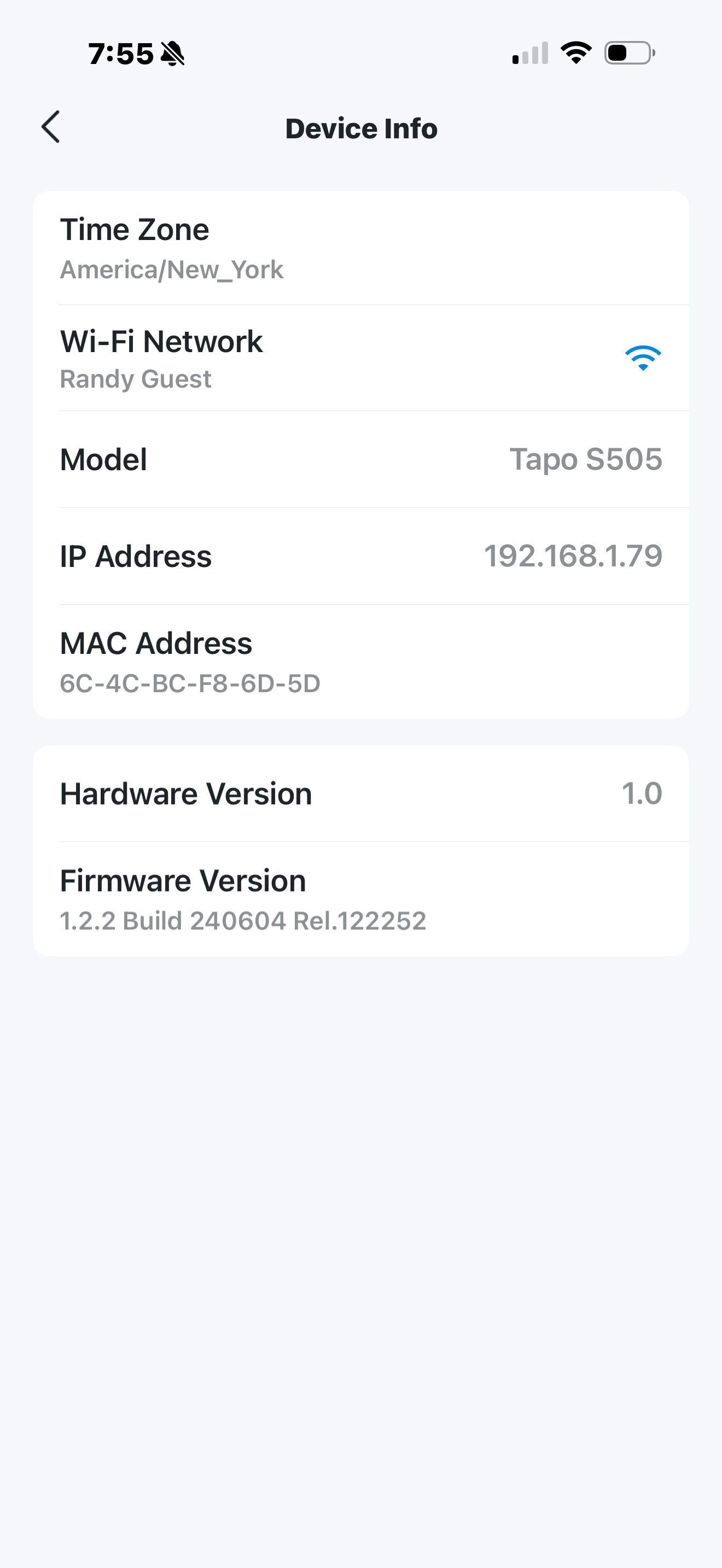

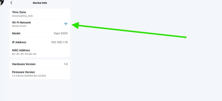

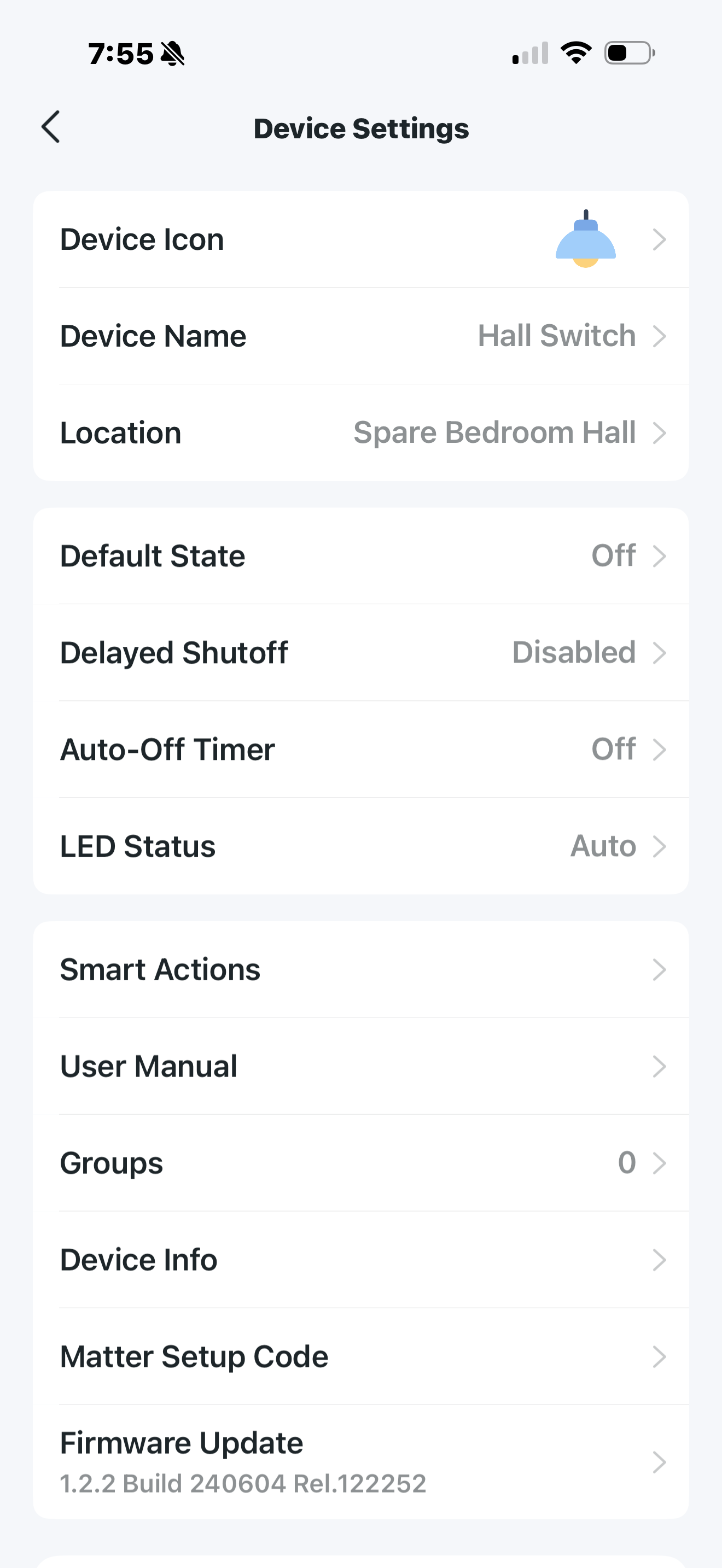

I’m gonna work on everything else, but I’m going to give you some screenshots until tomorrow morning. I have time to go through each and everything you posted such as my Wi-Fi settings but here’s some screenshots. Perhaps they might be a help and shed some light.
The items that are blue in the Tapo app are the ones I cannot get to work in the Habitat hub all the rest of them worked just fine in the Habitat hub
Hall Switch Below here has a nice strong blue wi-fi signal. I thought that was the problem. - Not!
