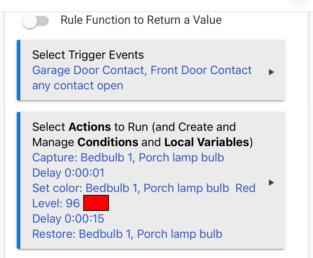

The downfall of this rule is that when someone re-opens the front door within the 14 second “red snitch light” is that the red light is selected as the capture and restore. So it stays red forever if that happens.
How do I lock out the contact sensor during that 15 seconds so it doesn’t retrigger the rule?

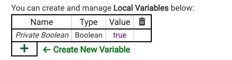

I tried to learn about the Private Boolean.
I think it would be a ‘condition’ but when I select that it defaults to true. I’m lost.

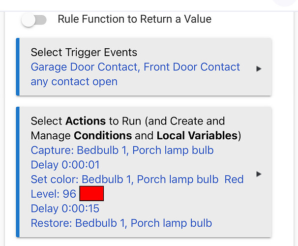

Could you write a sample rule with a contact sensor, capture-restore bulb command, 15secomd reset.
You’ll see I added a a delay in my rule to give the capture command time to work (based on a post here)

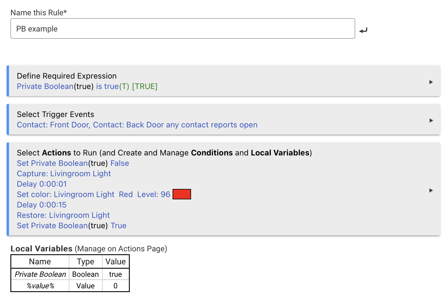

In your rule build, it doesn't matter at all whether the PB starts at True or False. Since the system defaults them to True when you're building them, that's what I (and most folks, I suspect) roll with.

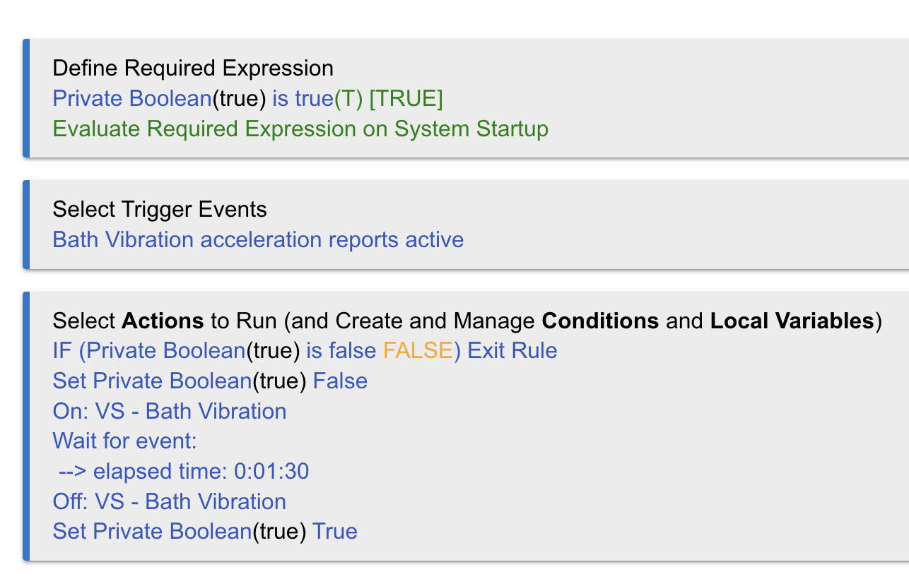

Here's a short rule I have using PB... For this scenario of preventing re-triggers, the PB needs to be a Req'd Expression. Per above, I always start with PB = True
Then the first Action your rule should set PB the other way (False in my case). Then build your desired rule actions, and as the very last Action, reset your PB back to original state (True for me). That way, it's ready to rock for the next trigger event.
In my example here, my very first Action line about exiting the rule if PB=False isn't necessary in most cases -- that's just an add'l safeguard I added in an abundance of caution.
ETA -- Don't get wrapped up about what True/False means -- they're simply state identifiers. They could just as well be Red/Blue, Lions/Tigers, Michelin/Firestone, etc.

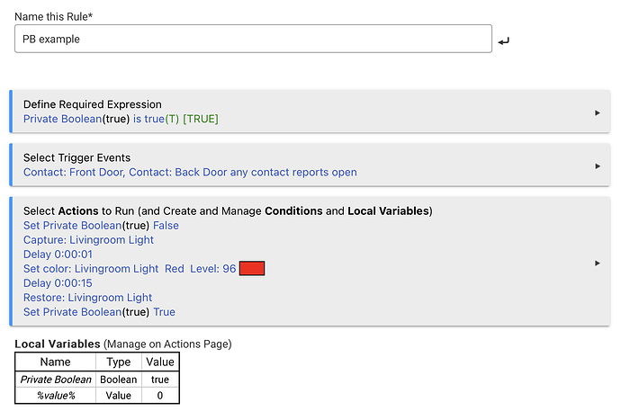

Here you go:
I've also exported the rule and attached it below. You can import it and change the devices to the ones that you use.
Rule to import
