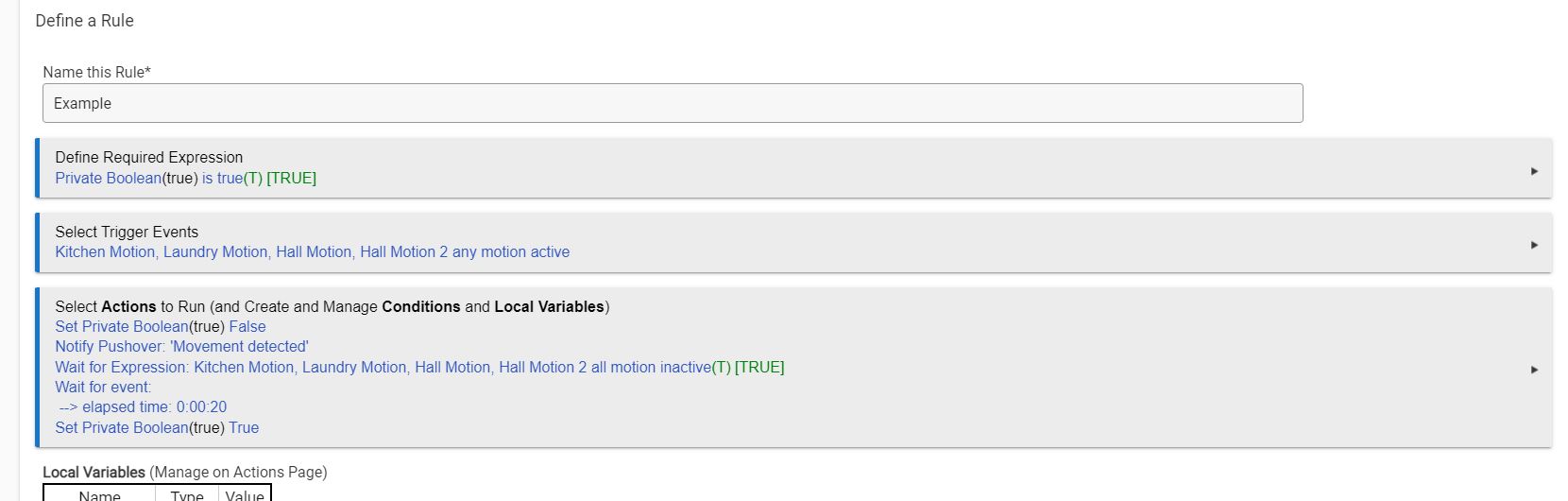

Okay so you only want the one alert I'd do something like this:
Obviously I'm using my devices but you get the idea here. We are going to use the Private Boolean to keep you from getting multiple triggers. So if the PB for the rule is true then it will look for the trigger. If any motion sensor sees movement the actions will fire.
The first thing the actions will do is set the PB to false so that the rule will not fire again until reset.
Then we send the notification and then wait for all motion to stop. Then we wait 20 seconds and reset the boolean.
Hope that does the trick for you and that I understood what you were looking for.
