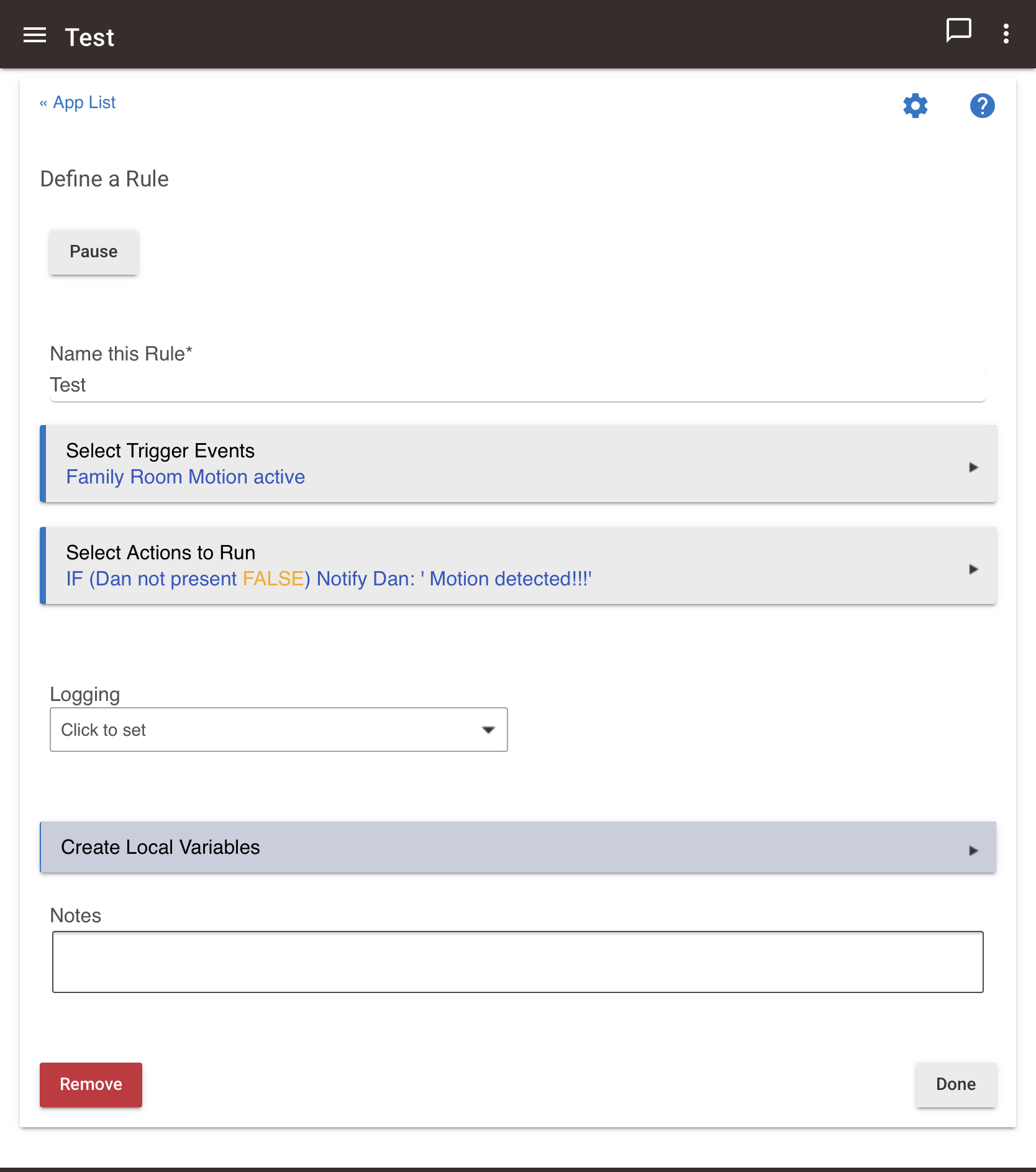

Here you go...
Motion sensor changed
Action
If motion sensor is active and phone isn’t precent THEN
Pushover
End if
Ok. thanks all, think I got it. Seems like a lot more steps are now involved to create a rule and some brain logic to assemble the rule In a runnable order. RM 4 no longer shows ( true or false ) after the rule like RM 3 did. It this correct?
Correct. You can still use Rule 3.0 if you want. Those rules won't go away.
