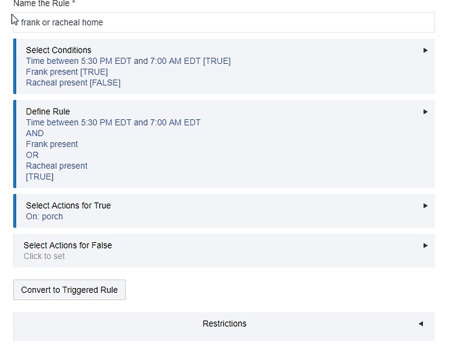

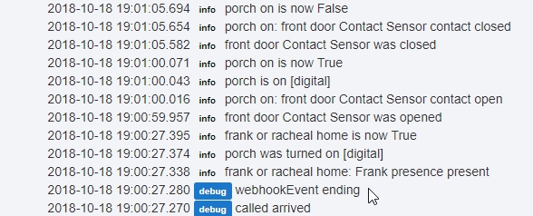

my presence is being detected by life360. the logs indicate it turns on the porch light but porch really doesnt turn on.
any ideas?
Since the log "on" event was produced by the light, not the app, and our drivers only produce events that are responses produced by the device itself, this seems odd to me.
Presumably the light can be turned on via the driver as well as the actual switch right?
yes. i also have the same light activated by a contact switch of front door and that works fine too. the switch works too
4
heres where the light actually did turn on with the contact open

Try one more thing. Open the rule and hit Done (with the light in the opposite sense of the rule truth --> if TRUE, have the light off). See if that turns it on or not.
i will change that and test tomorrow
