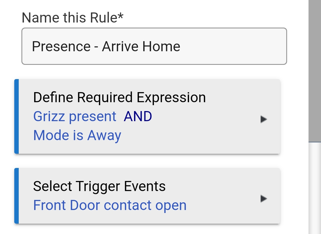

I think your idea of WifI plus a contact sensor on the door or motion is a pretty easy/reliable solution for an apartment.
As I work in my local neighbourhood I often drive past my own house, triggering the present status. My rule allows me to come and go but only triggers when I enter the house.

No worries! This is a really good solution!
