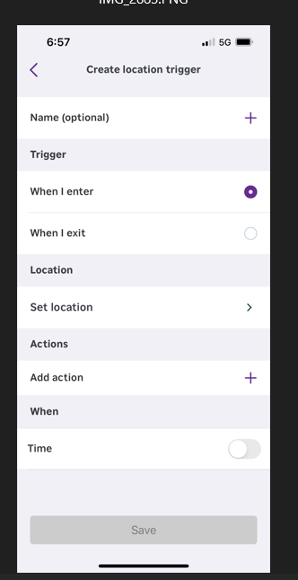

I see, you meant you would use your phone as a presence sensor and the Roku app to trigger an automation.
Have you tried the Hubitat app for this purpose?
See note above.
Purely proof of concept.
No I have not tried the Hubitat app for this purpose.
It is cloud-based as well, correct.
I am not sure how the Roku app does presence.
After all, each camera has a motion sensor.
Yes the Hubitat app uses a geofence around a location to trigger arrival and departure automations. This requires the cloud because your phone is using gps and its cell network to determine it crossed the geofence and communicate with Hubitat’s servers.
From your screenshot above, it looks like the Roku app would do essentially the same thing.
It does. I poked around on the app and it does use location services.
