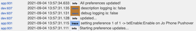

Hi,
I went to Preference Manager and selected all devices and set it to "Enable"
Unfortunately, when I checked the log, it does the opposite (disabled the log, rather than enabled it)?

What device driver is doing this?

Pretty much everything I have from the looks of it.
I have tried to do it one-by-one:
Hue Motion Sensor
Generic Zigbee Motion Sensor driver (Samsung Smartthings Sensor)
Aeoec Smart Switch 6
Pushover driver
ok, found the bug in preference manager, it will be fixed in platform 2.2.9.
