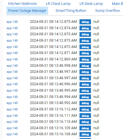

I am excited about using Power Outage Mgr(POM) to keep an eye on my electric utility. I believe I have installed and configured properly but, POM is not counting devices or sending notifications???
My system is C8 Pro and POM is V2.4. I selected about six devices for monitoring that were listed by POM. Here is what I see in the log coming from POM??
The only DEBUG info reporting is NULL.........
Thanks........
What brand/model devices have you selected to use as the reporting devices?
ETA... Many/most (and perhaps all) of the options presneted in the POM selection menu are in fact not compatible to use (well, that's true for me anyway).
The reporting devices must be capable of reporting mains power vs battery power, and there aren't many such devices available.
The Ring v2 extender, Zooz ZAC38, and Zooz Titan with battery pack are the only 3 such devices that I'm aware of (but there may be some others out there).
Edit 2 -- device clarification below from the man himself -- thanks!
Device must have one attribute of powerSource, presence or healthStatus to trigger an event.
Ecolink chime siren.
Honeywell T6 Pro Z wave tstat

My devices listed were Zooz ZEN07's which are older zwave outlets with voltage reporting. But, they are not battery supported.
I really want to 'see' the power outages and will pick up one of the supportable devices.
