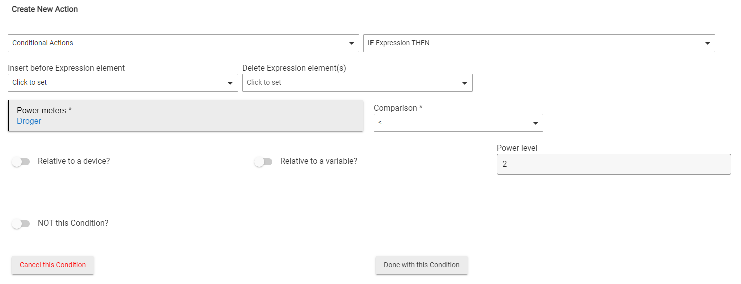

Is the same possible when checking a power level?
I cannot seem to find it.

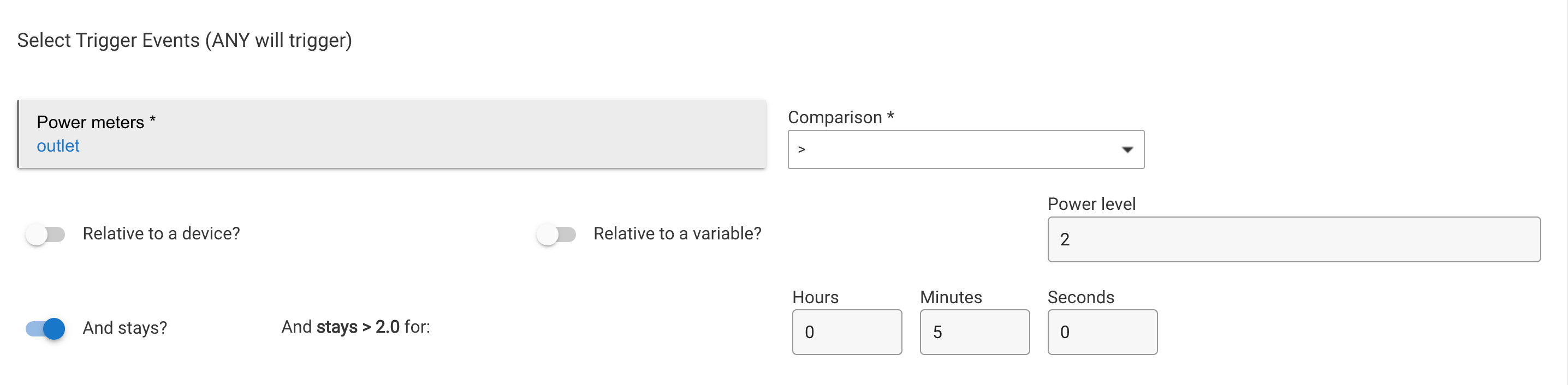

I'm not sure you can do this with a conditional statement within the rule for either motion or power but you can do it with either in a trigger. If you want to do it within the body of the rule you could use "wait for event" or "wait for condition" and check for a timeout. Or perhaps "time since event" depending on how you want the rule to work.
I'd suggest maybe using > rather than =.

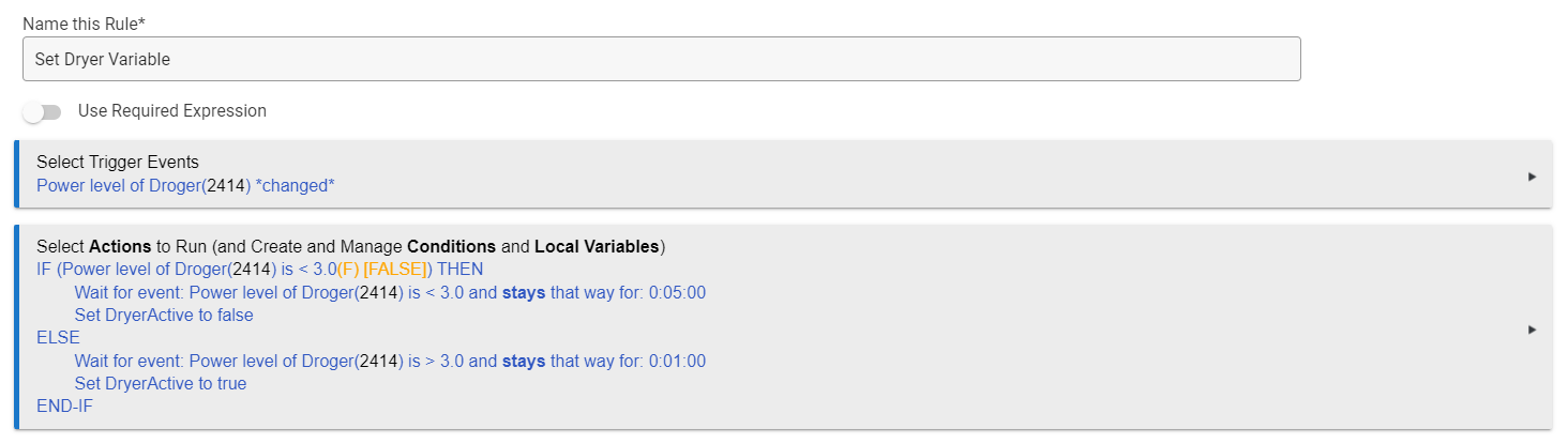

Re-created the rule and testing it now.
I think you may need to check after your WAIT whether the WAIT met the condition or just timed out.
It should stay waiting until the condition is met i think?
Yeah my bad. I was thinking that 5 min was the timeout.
Looks like it is working.

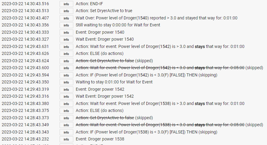

Maby I need to add a cancle delayed action as the first action?
The waits should get canceled when the rule re-triggers...
This, every time the power changes, the rule retriggers and your waits start again.
