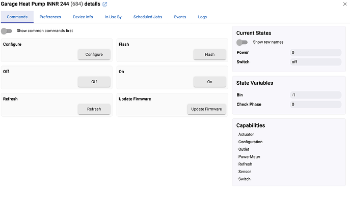

Generic Zigbee Outlet:
(It says “PowerMeter”)
But not Energy Meter, so that explains why this one doesn’t show up.
