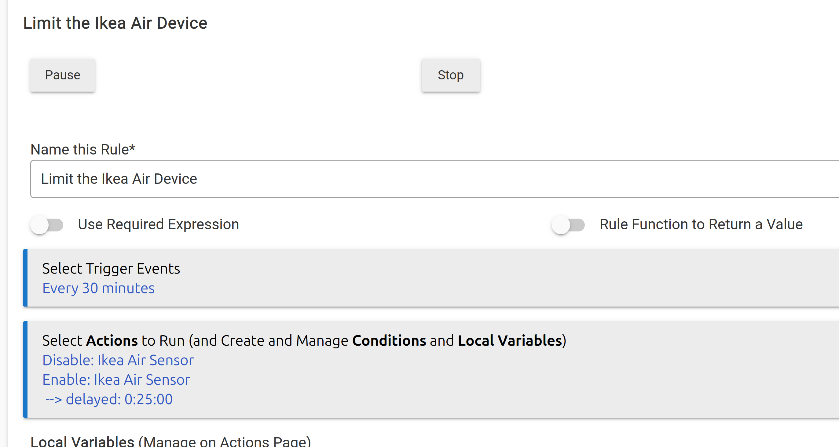

Another approach from Rule Machine o disable/enable a device:
