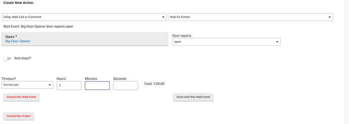

Timeout sets %device% to "timeout" when that is how the Wait ends. So you can put %device% into a variable and test it, exit the rule if it is "timeout".
Hi Bruce, sorry if I'm doing something really obviously wrong here, but I wanted to play around with this and don't see that as a variable that I can actually use in my test rule.
I see it on the Rule page:
But then it's not there on the Actions & Conditions page (and therefore not selectable as a condition):
You need a String variable to put %device% into, so that you can test the value. See where it says Create New Variable.
Duh. Got it. Thanks.

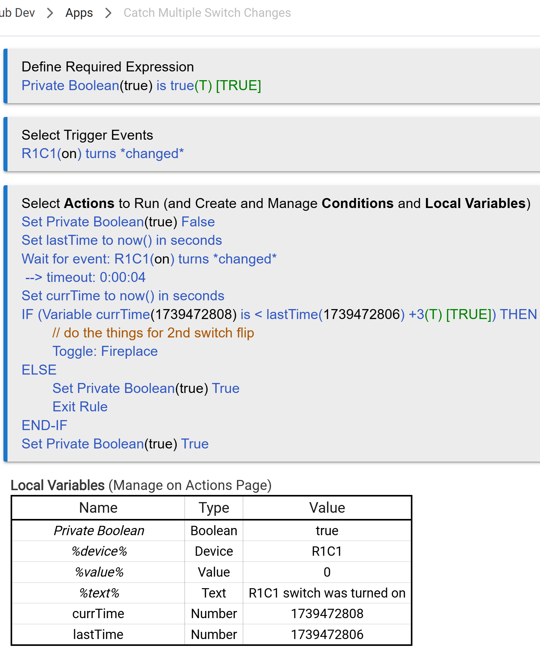

OK yeah, I think based on Bruce's feedback, something like this would work - the logic is that if there is another 'on' event within 5 seconds I want it to turn on the other light too and if I don't turn it on again, nothing happens:

Have you tested this rule? As I see it, for this to work, the driver will have to send two of the same event in succession, i.e. On event followed by a second On event within 5 seconds. Which drivers permit that?
This was in my original proposal to him, in my mind it was implied that this was still the case:

But I got it to work!
I will test this solution in a bit but,
Here is a solution from another thread:
