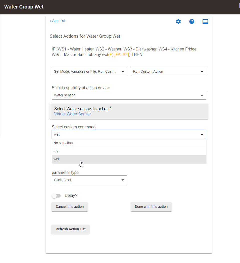

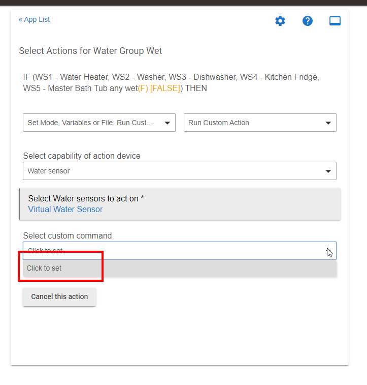

So I'm not getting any options when selecting the custom command for the Virtual Water sensor. The virtual device type is the Generic Z-wave Water Sensor. Maybe I need to try a different device type for the virtual water sensor?

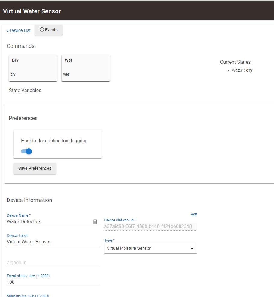

OK, I changed to the Virtual Moisture Sensor which appears to let me toggle the states:
That's it, I believe you can only change states of virtual devices!?
