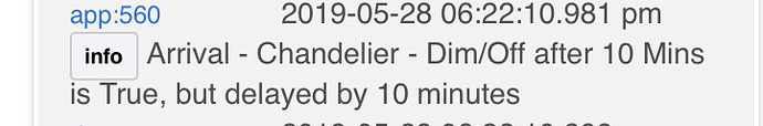

This is a newer triggered rule for me, so can’t verify that it worked in older versions. At 6:22pm this should have evaluated as False, but was somehow true. Any ideas?
That log entry is not from the rule being evaluated. Please turn on all logging for the rule and show more logs to establish the full context of what is going on.
Sure, I manually set my presence to departed and then arrived, to test. Same result. My light turned off instead of 20% as expected.

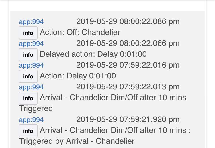

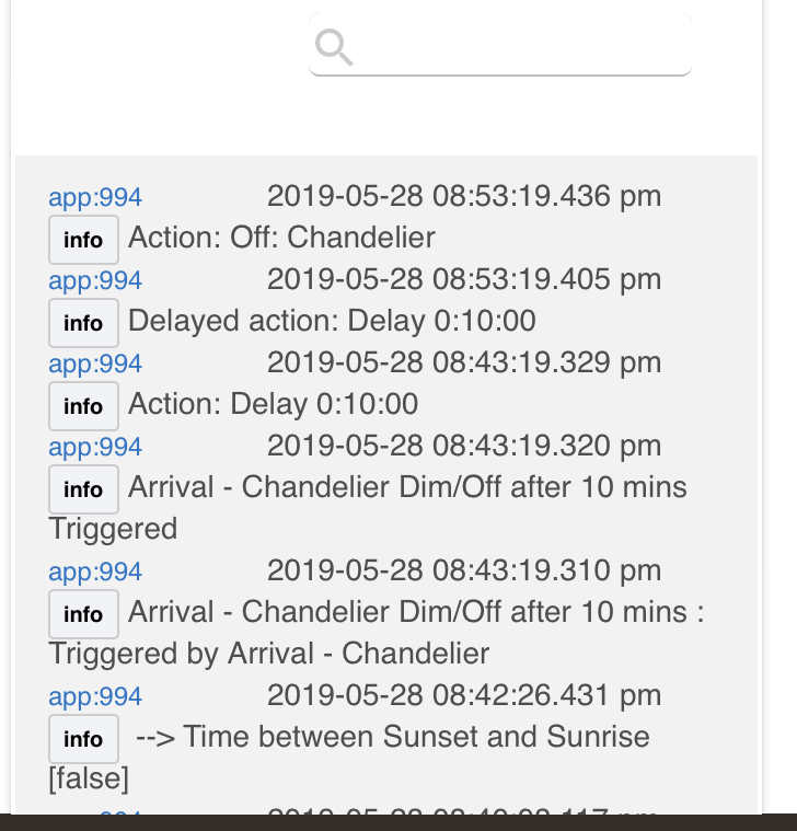

Still a mystery, switch turns off 10 mins after arrival instead of the expected 20% level set.

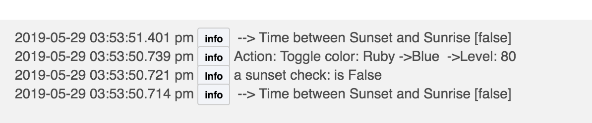

Here is my test rule:
It's before sunset here now as you can see from the FALSE for the Rule. When I trigger this, the color light comes on blue, as expected.
Suggest you see what happens when you hit the Run this Triggered Rule button. That just omits the Trigger Events and does it manually.
This is what the logs look like:
Your logs seem incomplete. Do you have all logging options checked? Not seeing a log entry that looks like this:

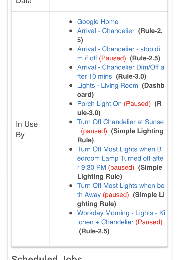

Look at the Chandelier device, and see if it is in use by any other app. At the bottom of the page, like this:
We’re getting somewhere.. when I manually run the triggered rule it dimmed the light after 10 mins as expected.
This device is used in multiple other rules. I’ll go through them and see if I can find the conflicting rule.
I’ve paused almost all rules that use the device and I still don’t get the expected outcome. :thinking:
