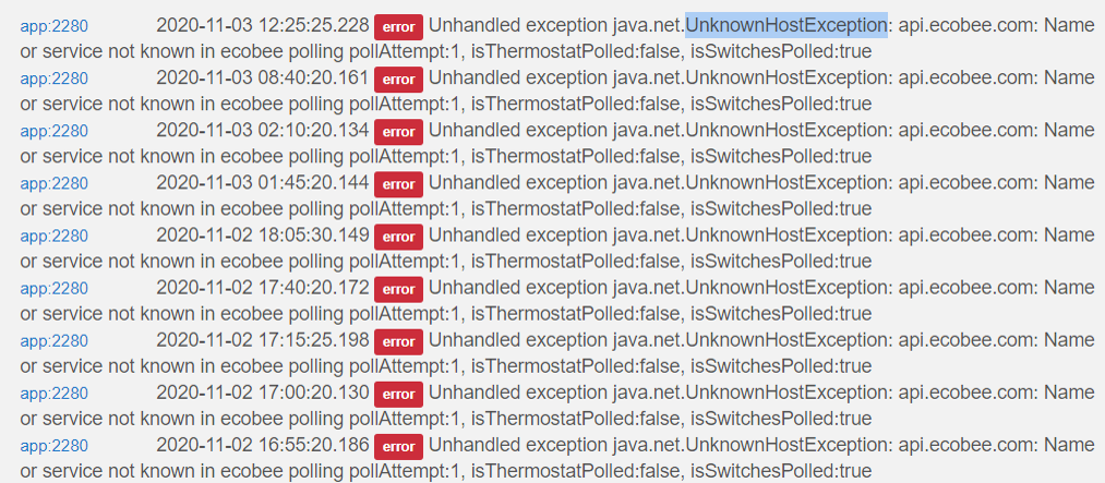

Possible solution for Ecobee Integration, UnknownHostException?
The solution on the OpenHab platform was to increase the timeout from 10 to 20 seconds. No idea if that will help on HE or if it can be implemented.

I'm going to go out on the limb and say that api.ecobee.com was unavailable when hub software started, which resulted in an "unresolved" cached DNS entry. In upcoming version 2.2.4, DNS cache has a timeout, which enables hub software to properly handle NTP over unstable network. Same setting should help with Ecobee and other similar drivers as well, with no development effort required.
For current versions, the only way I can think of to address this is a hub reboot from diagnostics tool. That will clear DNS cache. If a reboot doesn't help, then I'm wrong about the root cause.
This occurred before and after rebooting the hub for another reason.

Ahh this is DNS only, thought it was also possible to adjust for slow http requests. However on closer inspection of my original post, it does appear to be a DNS error. I recently switched the default DNS in the ORBI router and have not seen this for a while.
