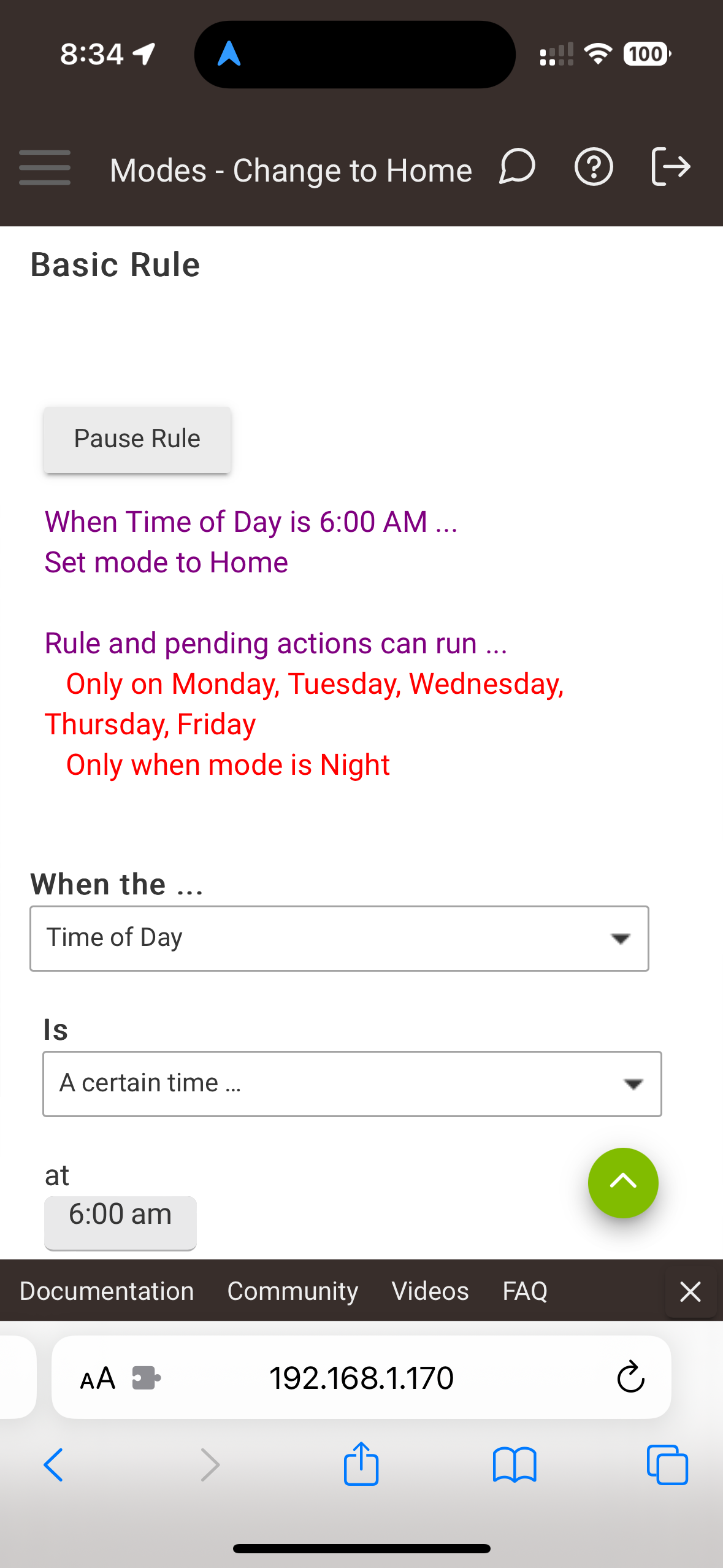

Today my mode change from night to home failed to run @ 6am. My hub was online and working and should have been in a clean state due to having rebooted over an hour before.
No clue why. No, there are no known time based bugs.

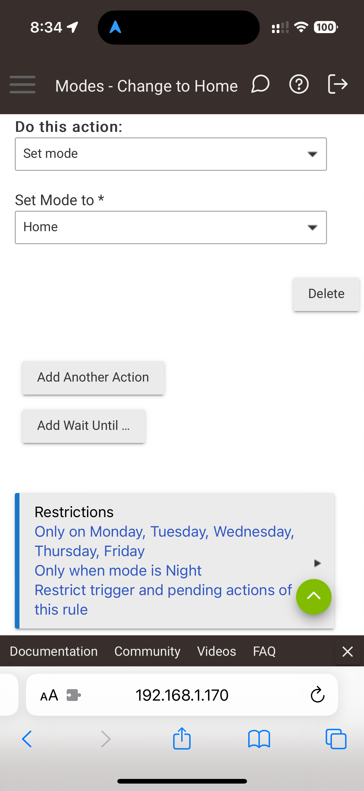

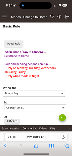

As above, my really simple rule failed to run at 6am - could be an edge case tho, as it has been working fine for a really long time. So long in fact, I couldn't recall how i'd configured the mode change over.
Ah, you live in the Southern Hemisphere. What time is sunrise? If it’s before 6 am, your mode might not have been night.

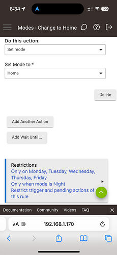

Sunrise shouldn't have anything to do with it, the rule uses 6am as a fixed time.
Maybe totally unrelated and I chalked it up to power outage shenanigans. Buuuutt..... Yesterday, my early morning to home mode transition failed to execute. I noticed at 8:30 that the lights were still reacting like my early morning setup.

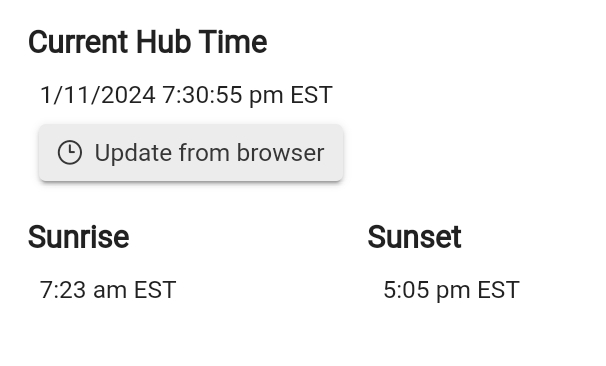

Again, the night prior, we had a 5 hour electric and slightly longer internet outage due to severe weather. I chalked it up to the fact that although the hub was on at midnight (assumed the sunrise/sunset check runs sometime around there), the internet was out till around 3 AM. So, I was thinking the hub did not get sunrise/sunset data to know when to run my mode transition which runs at 6 AM also unless Sunrise -15 is later than 6. Right now it is not. Usually around 7:30.

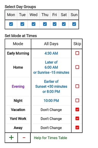

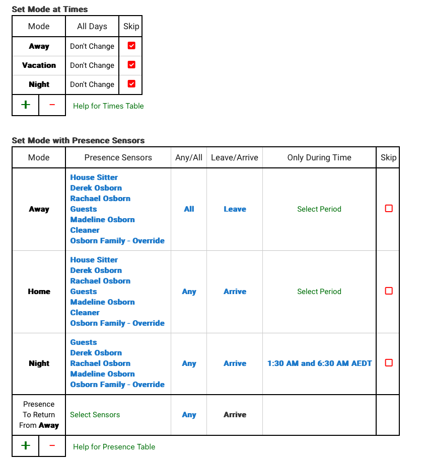

My Mode Table

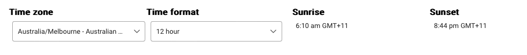

Current Sunrise/Sunset info

Interesting! I have been using Basic Rules to change from Night to Home for ages, just becasue it was easier at the time (several years ago).
The reason I picked on Basic Rules as the possible culprit is Mode Manager only responds to Presence, not time in my config. After my Alarm panel started beeping at me, I went into my HE Security dashboard and manually changed the mode to Home and everything worked after than.
Mode Manager Config

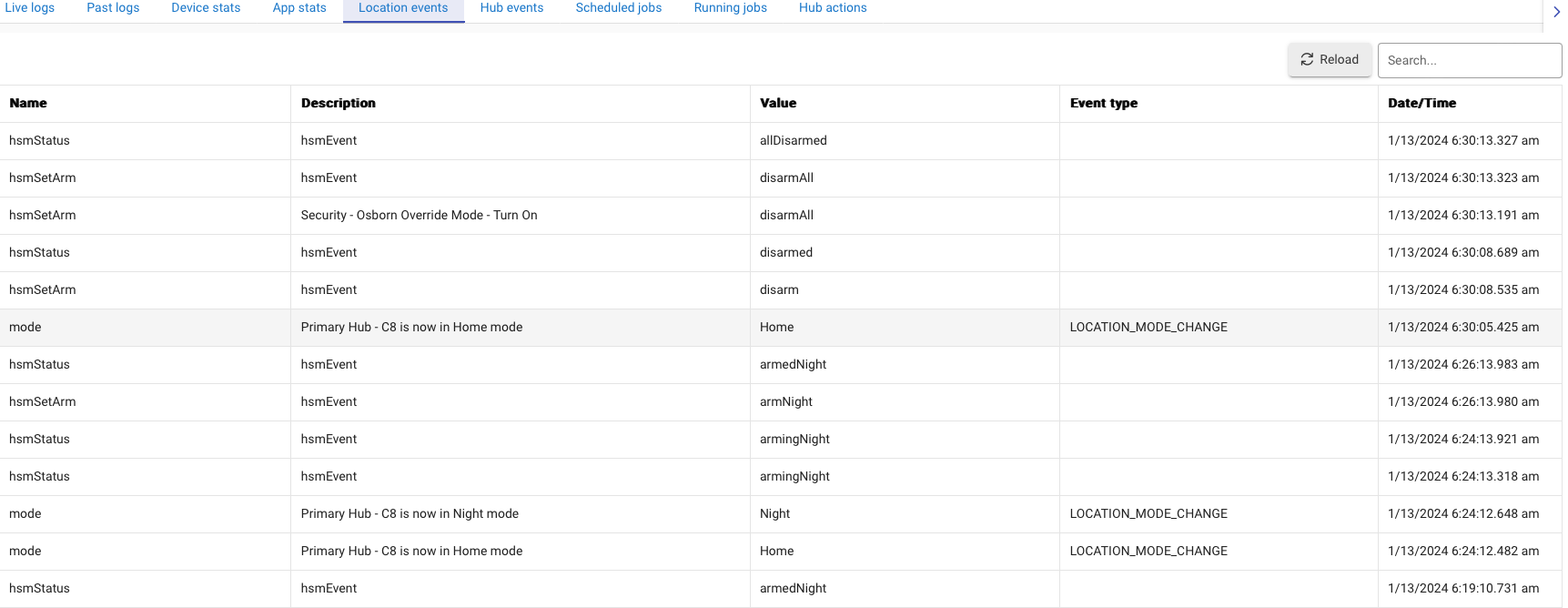

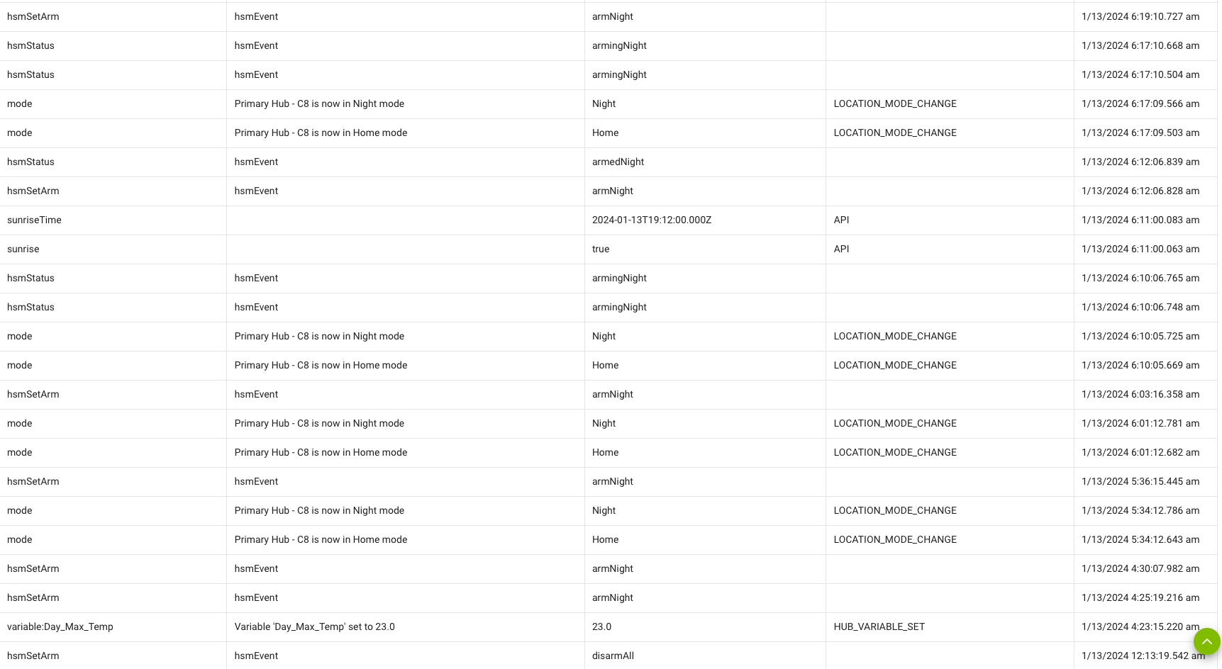

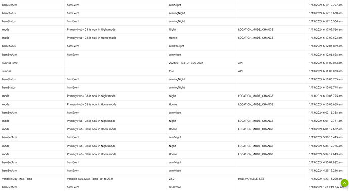

Huh, I've never seen that before.... my modes all went haywire. :scream:

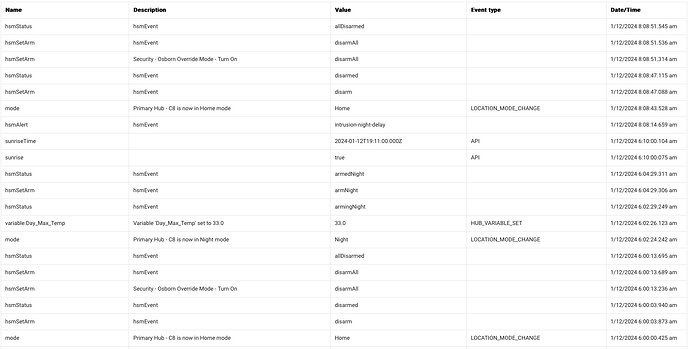

EDIT 2: Doh! Device logs dont go back past 6:35am, so I cant see what else was going on. :man_facepalming: However based on the Hub events, Mode Manager changed the mode back to Night at 6:02 am, but I cant find any rules I have that could have done this.

Could it be the disarm events shortly after 6am? It would a fair delay if it was...
Night mode turned back on a full 2 mins later tho. The thing is, I do not automate Night mode turning on ever - it's 100% manual via voice command or alarm panel.

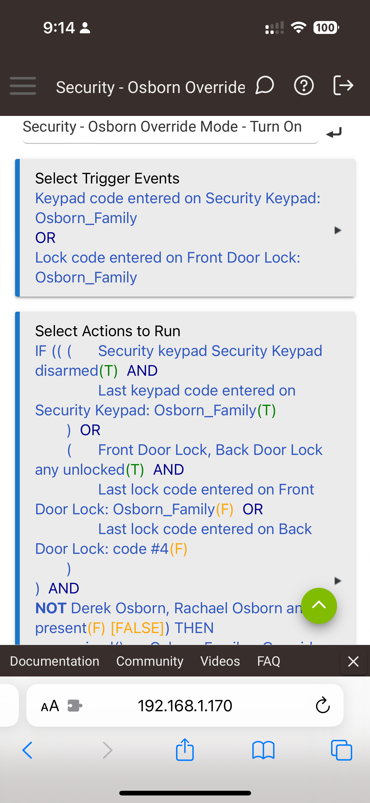

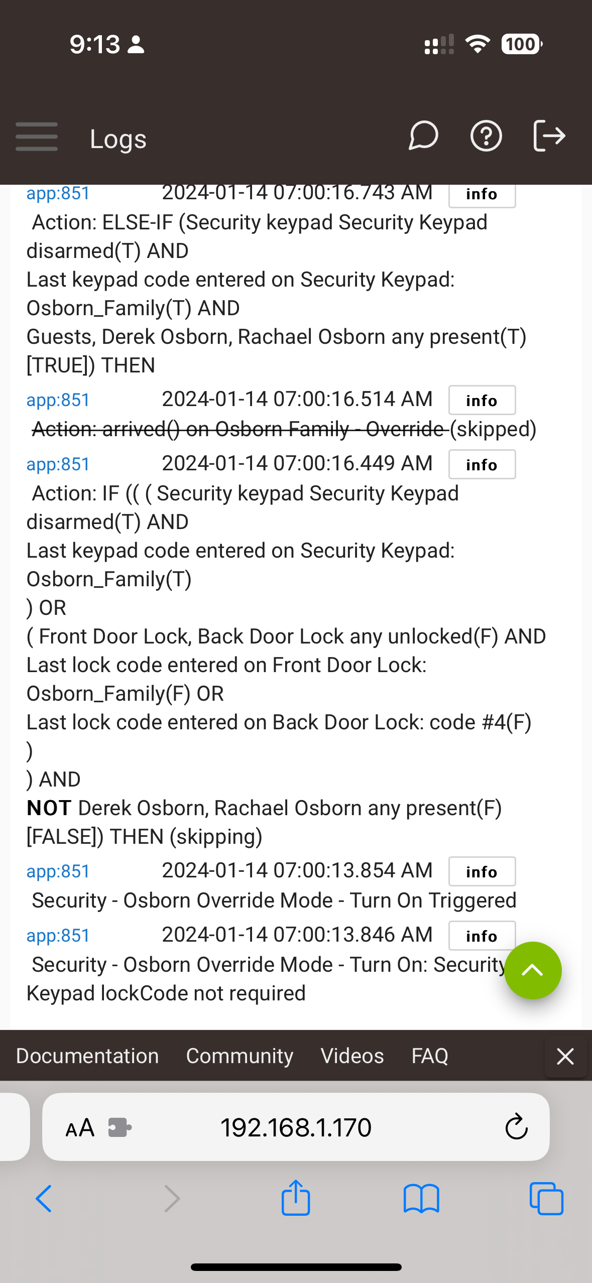

The other thing that confuses me in those logs is the "Security - Osborn Override Mode - Turn On" mentions - that rule requires manual activation????

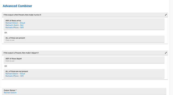

After being woken up at 4:30 am by my alarm panel and seeing lights on that only turn on when the House state changes from Night -> Home, I picked up my phone a look at the logs etc. I then heard Alexa announce that my wife had arrived home. So I checked logging for my wife's instance of advanced combiner, as it manages her "presence" for Mode Manager.
SWMBO

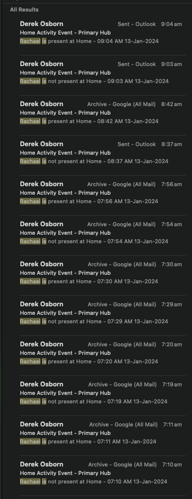

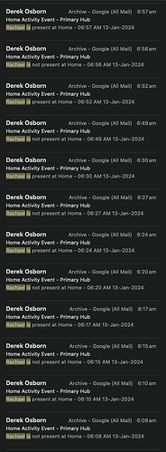

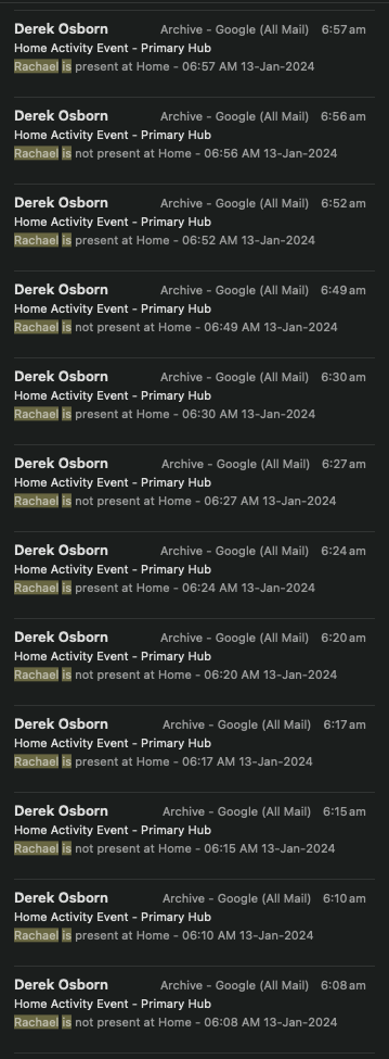

Any way, what I found in my logs was her presence flapping quite badly, as her iCloud presence had stopped updating and showed her as away.
SWMBO flapping so hard she should have taken off
Anyway, it turns out that with her presence flapping, it had given Mode manager a hard time and it was ignoring my presence (which seems fine and is stable) and causing house modes to play up.

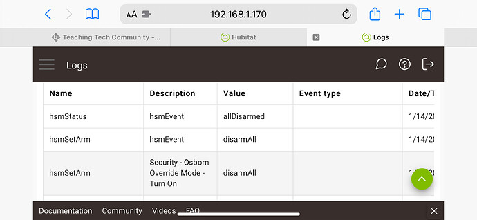

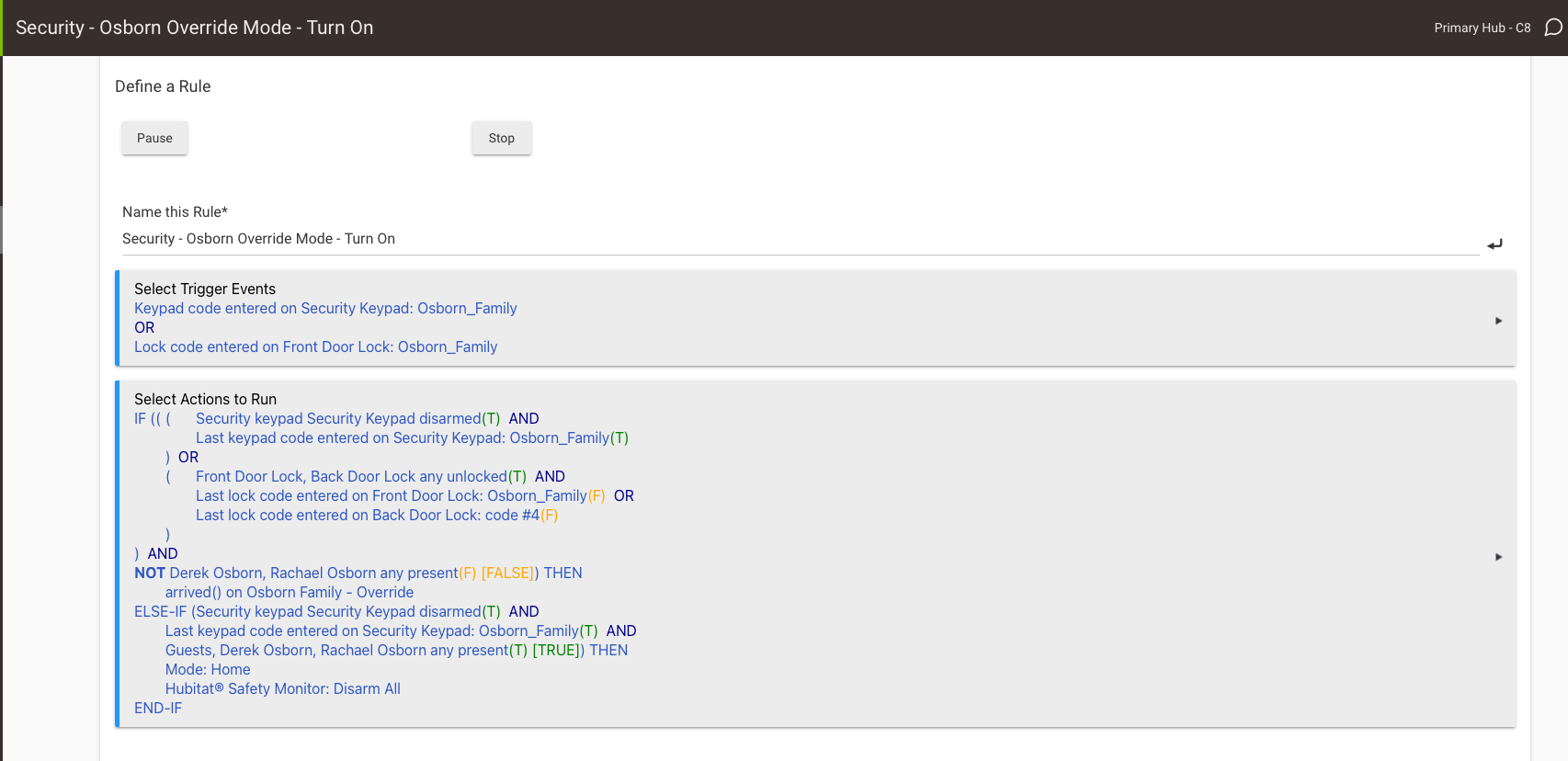

What I cant explain is this entry in the logs "Security - Osborn Override Mode - Turn On". This rule requires the keypads on my deadbolt or alarm panel to be physically used.
Loose end

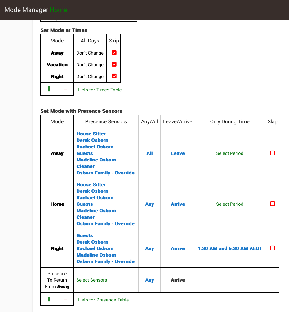

Anyway, I think there is a bug in Mode Manager that is preventing it from behaving correctly in the case where one presence sensor is misbehaving. I think it should at least be fairly easy to simulate in a dev env.
Mode Manager Config

The setup is not as complex as you suggest. Mode manager relies on 3 presence sensors to detect us coming home, and 2 leaving (daughter forgets her phone sometimes so hers isn’t included).
I was home the whole time and my logs show I did not leave during this issue. As my wife’s presence was relying only on wifi and ble for presence as her iCloud component had stuck, her presence overnight was frequently changing from home to away.
Once I found this was the case and fixed her iCloud presence, everything stabilised.

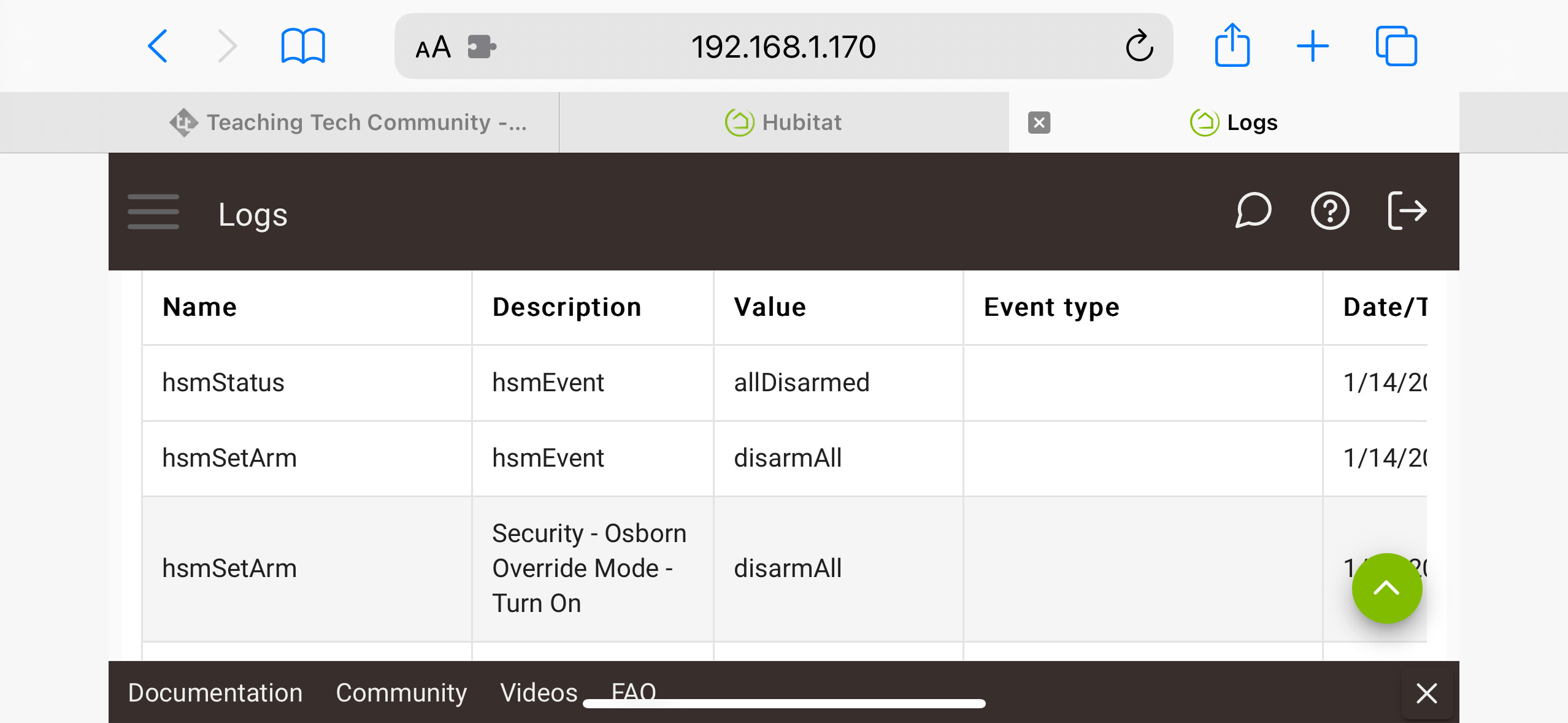

The only thing I’m still seeing is this Legacy RM rule is still running.
Despite it supposed to be only triggered by my keypads.
Any idea?
The logs show that it was triggered by Osborn Override Mode Turn On, but you don't have such a trigger. So, either you used to have one and never hit Done, or there is some vestige hanging around. Why don't you simply re-create that in Rule 5.1? That would take less effort than posting here about it and me spending time on it.
