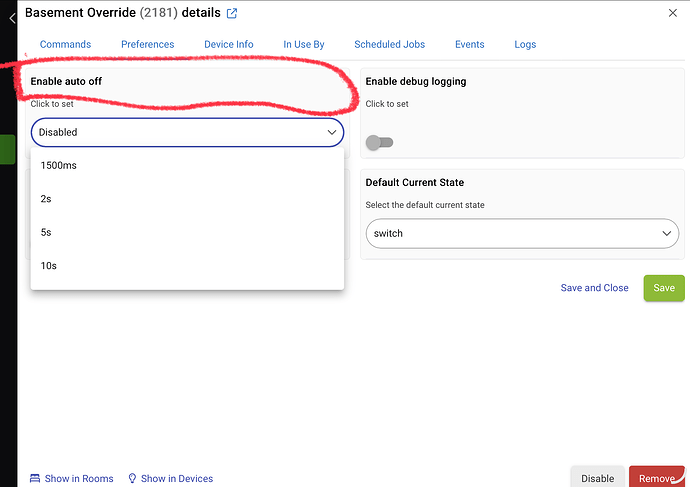

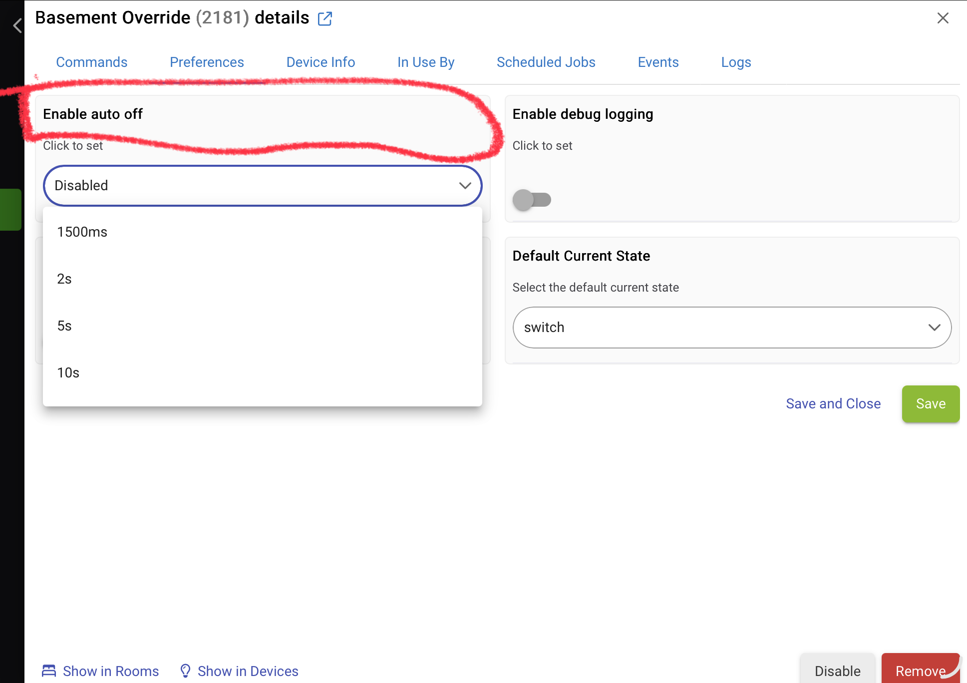

Also check that your preferences don't have the option to auto off
Sometimes it can be the simplest things....
That was my first thought and it was off. I even tried turning auto off on and then back off in case it was not showing the correct value. The issue still happened. I did have something external calling the 'off' rule that was by design. That was not what was causing this, I even shut down that device to ensure it was not sending the command.
