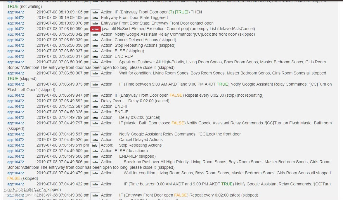

Bruce, I'm assuming "cancel delay actions" should work on both an action with a delay and a standalone delay actions? I'm seeing an error in logs related to delayed actions in rules where I'm using a standalone delay actions and cancel delay actions in the same rule.

At least I can tell right where it's throwing the error. Since the error comes after the final END-IF, does the rule work correctly anyway?
Are you sure these logs are from the rule you showed above? I don't understand what it's showing in those logs. For example, in the rule you showed above the final steps are

I understand what the commands do. What I don't understand is the logs showing that IF (Master Bath Closed) action AFTER the rule has completed running the final three commands.
The logging is a snippet of "past logs" centered around the time of the error, perhaps the last entry was a result of new trigger after the rule has already run. Since the rule is tied to the front door it does get a lot of activity throughout the day.
OK. So turn on all of the rule logging, so we can tell what's going on. As it is, there's no way to tell. Those logs are very confusing, and don't line up at all with the rule you've shown. So until then, it is impossible to even begin to tell what is causing the error. Also, need to capture the entire log sequence of the rule being triggered until it throws the error.
