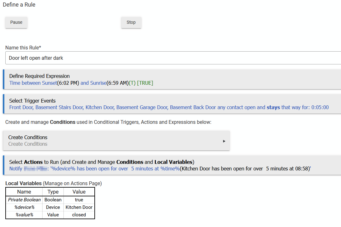

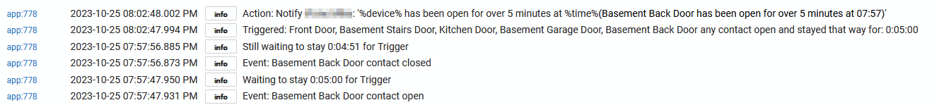

My rule and logs:
I’m having a similar issue with contact sensors. I have a rule to notify me if a door opens and stays open for more than 5 minutes after dark. I swear this used to work correctly, but now, anytime you open a door after dark, you get a notification 5 minutes later. I opened the rule and watched the variable go to open a then back to closed. 5 minutes later, i got a notification that a door was open.

I'm not able to reproduce the problem, as I demonstrated above with a rule and logs.
This rule has been in place for quite some time. I only recently noticed that it had begun misfiring.
I removed all the doors except the one I was testing with. With just one door trigger in the rule, it works as expected. Something must have changed.
