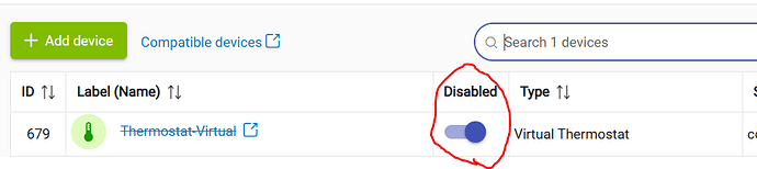

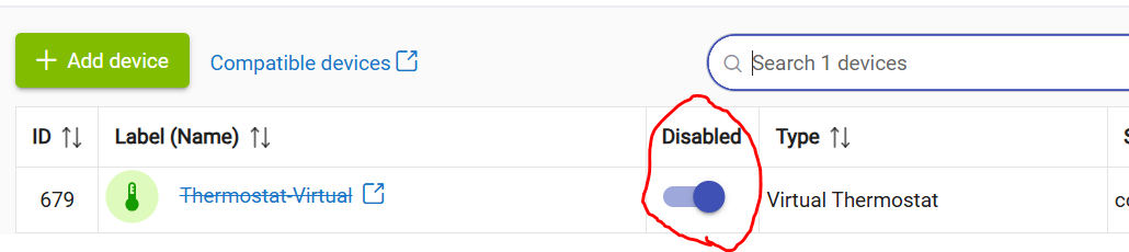

Noticed this also on ver .144. Generic Zigbee outlets showing up in the "Lights" bubble at top. Although maybe most are using an outlet to turn on lights anyway! "Power" bubble is reporting the outlet wattage properly.
Also one more thing, I have a "disabled" virtual device showing up on top. Wouldn't that fall into the Hidden category?
When I click on it...... Disabled for sure
Disabled โ‰  Hidden. To hide a device, click on the :eye: looking thing.
Well thanks. Just thanks. I'm going to be up all night freaking out over that scary eye. :astonished::wink:
Use the time to bake bread.
Update - after later issues with app failing to load, I rebooted no joy.
but oddly disable app and then re-enable fixed loading issue, very odd.
No, but it shouldn't count disabled devices at all, regardless of selections. It doesn't make sense, to think of it.
