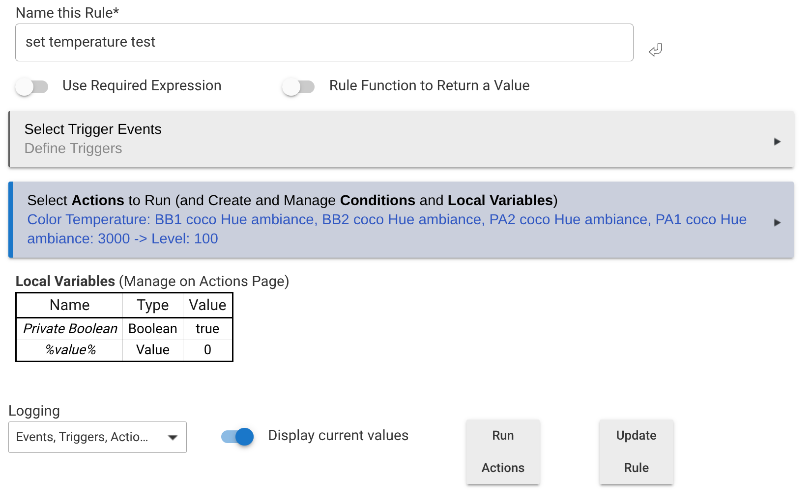

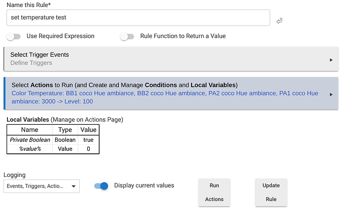

If just for testing, a simple Rule Machine rule, select bulbs, set temperature, run action.
