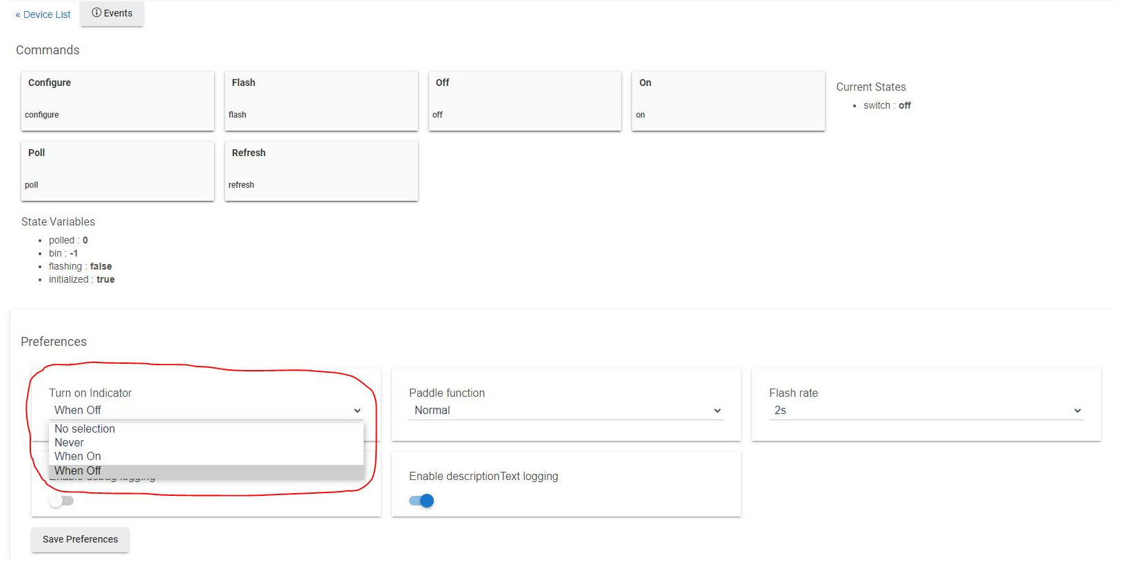

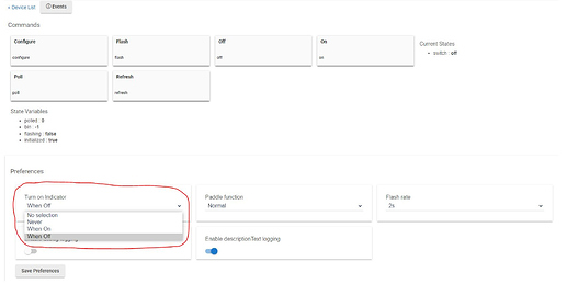

If anyone is interested I actually finally got the Popp Outdoor plug to work.
If I choose anything other than "When Off" for "Turn on Indicator" for the "Generic Z-Wave Switch", it is not possible to turn off the device from the hub (only possible to turn it on).
When I have "When off" chosen, I can turn on and off the switch without any problems.

I thought the "Turn on Indicator" was if the LED light of the manual button on the plug should be on/off etc. when the switch is on/off.
