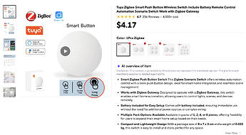

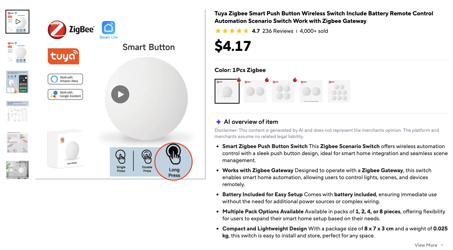

I bought these cheap zigbee buttons from Aliexpress about a year ago for about $2 apiece. The seller's description (screenshot below) indicated they support single/double/long press, which is all I needed.

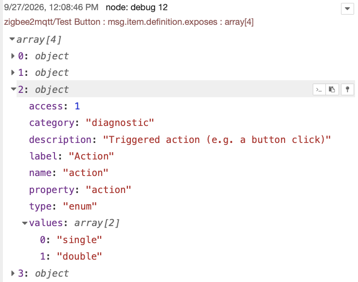

Single/double press work as expected. Long press doesn't generate an event. It just resets the button and puts it into pairing mode, so one has to pair to the coordinator all over again.

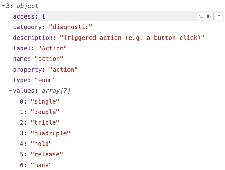

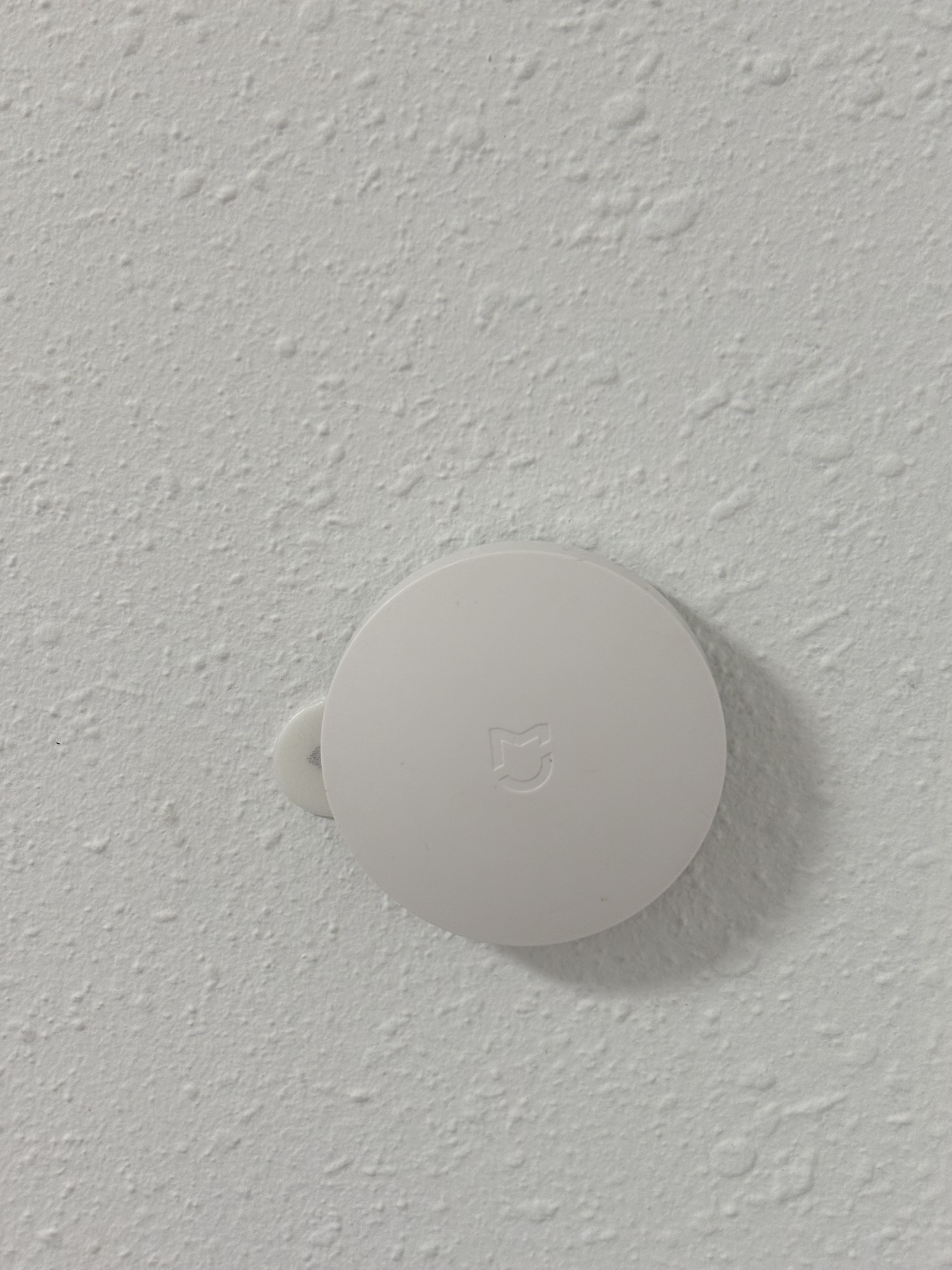

I have these old (original) Xiaomi/Mijia buttons:
They are capable of the following actions:
Single/Double/Triple/Quadruple/Many/Hold/Release
If you have the same buttons, then it is possible that the driver you are using only exposes "Press" and "Hold". Or maybe you have different buttons.
Yeah. I looked at the driver and there are only 3 options, push, hold and Dbl tap.
