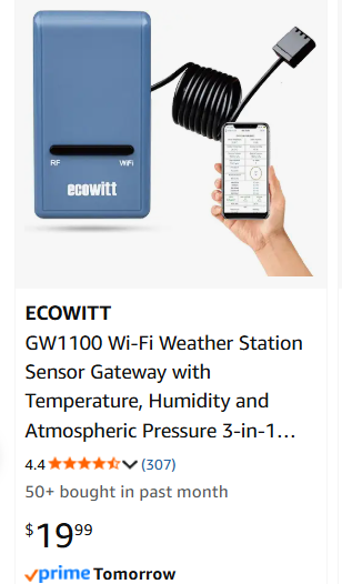

Not directly. You’d need an Ecowitt gateway device as well.
Sensor talks to gateway over a proprietary RF connection, gateway connects to WiFi or Ethernet (depending on the model of gateway) and then there is a community-developed integration with Hubitat that can talk to the gateway over the LAN and bring the sensor data into Hubitat.

Yes, I tried Zigbee sensors, they just couldn't reach out to the pool. The Ecowitt gateways are only like $20.
The gateway is accessed through the Ecowitt app. You can set a custom server in settings, and set it to send data to your Hubitat IP address locally. The integration parses the files dropped by the gateway, and automatically creates devices for anything connected to the gateway, as soon as it reports data.
There are many devices that can be connected to that gateway, including soil moisture sensors, temp/humid sensors, fill level meters, irrigation valves, and leaf moisture sensors, as well as the full weather stations that come with rain meters, wind meters, lux sensors, lighting sensors.. If you buy a weather station, it comes with a gateway. The gateway itself is also an indoor temp/humid/pressure sensor. That device will be created just by adding the gateway to Hubitat.
The add on devices are fairly inexpensive, all you do is turn on the new device, the RF gateway starts getting data from it, and then when that data goes to Hubitat a new device is created in Hubitat.

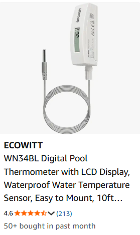

The solution I settled on was to purchase a Ecowitt GW1100 Wi-Fi Weather Station Sensor Gateway with the WN34BL Digital Pool Thermometer. The only information I could find regarding ECOWITT & Hubitat was outdated by several years and no longer accurate. I am simply using the Ecowitt App to monitor without any Hubitat integration.
I use a Sonoff TH unit, converted to Tasmota. I have a temperature probe in the Botton of my pump and one in the outdoor box. It provides me outdoor temperature, and pool temperature hardwired into Tasmota. The same unit controlled my pump for years, but this year, I'm switching it to a Zigbee breaker for higher current capacity.
Thanks for the info - I installed my Ecowitt about 2 weeks ago and all is fine. The tiny (16cmx30cm) base is on my patio and reports the patio temperature, and the wireless pool thermometer is in my skimmer basket to report water temp. They both provide plenty of data and historical graphing. All is well as we approach swimming season here in South Florida.

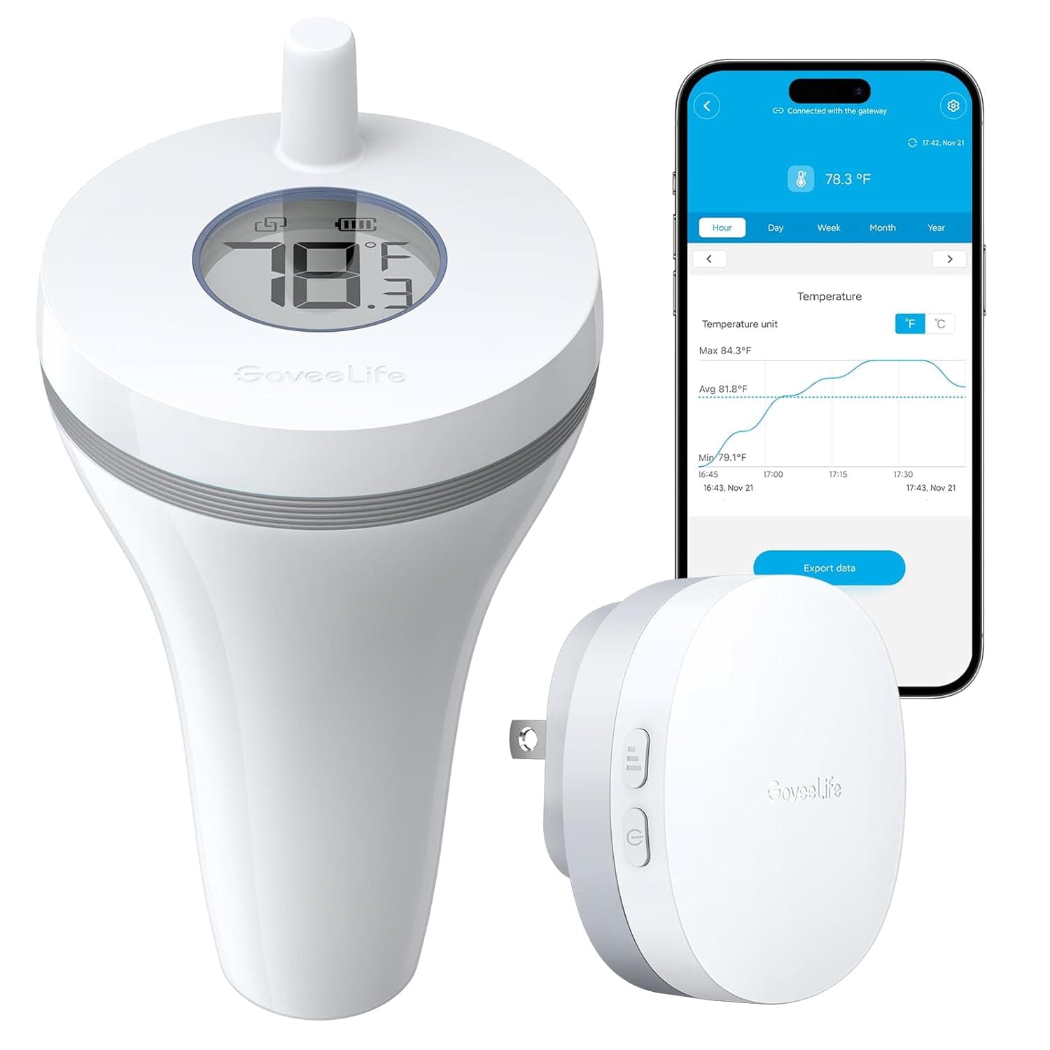

I'm using (and wrote) this $25 pool temp sensor. I've had it for 2 years now and no issues. The driver is new though. The reason the driver is necessary is - at least at the time of this writing is - govee API doesn't expose the pool temp sensor. If/when that changes this is a more generic app to use instead
