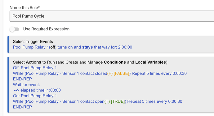

Finally got around to adding the repetitive commands. This rule seemed to work ok up until early this morning:

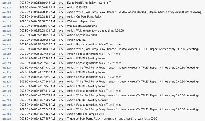

at 3:48:07 the OFF command doesn't stick and the rule starts to repeat like it's supposed to.
After 5 tries it still doesn't turn OFF but the rule keeps running until it's time to turn ON at 4:50:08 then the rule stops. Is it because the run contact is still CLOSED? At 7:53 I manually stopped the pump.
I thought the rule would keep running until the relay eventually responded to the command.
I tried this rule out on a spare ZEN17 and used a switch to simulate the run contact opening and closing and never had the rule stop. What I couldn't simulate was the relay failing to respond to the command.

Your while loops dont have any actions in them, what are they supposed to be doing?
If you want to Turn it off then make sure it is off the While loop should run while ON, and the action in the loop should be to send another Off command.
Also your blank "Wait for Event:" you should change to just a delay actions of 1 hr.

As mentioned above you have the loop whiles backwards. You want to loop, if the device did not respond. Inside the loop you want to resend the action that did not occur. Once it does it will exit the loop, if the device is working properly it should not loop at all.

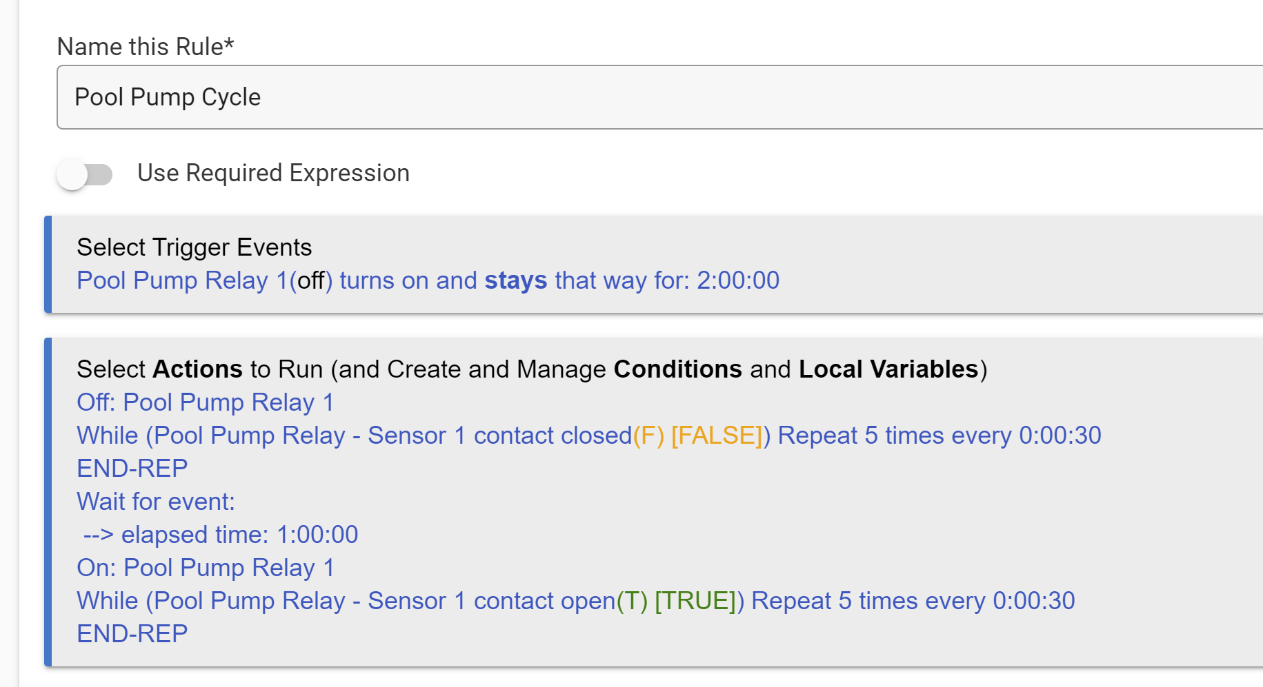

I see what you mean, here's my next try.

I’m not familiar with that device, but when the pump is off the contact is closed? That seems backwards,
No, it's just an auxiliary contact on the motor starter tied across the S1-C terminals on the ZEN17. When contact is closed pump is running.
My thought process is that if the off command is given and fails then the contact is still closed and keep repeating the off command until it opens.
Am i β– β– β–  backwards here?
I had gotten this to halfway work before I discovered how to expose all the attributes on the ZEN17. So I didn't change course.
Okay, should work then.
Perhaps you should add a notification, that if it gets past the loop and it’s still on or off it will let you know.
Good idea, right now it sends me a notification when the RUN contact changes state.
