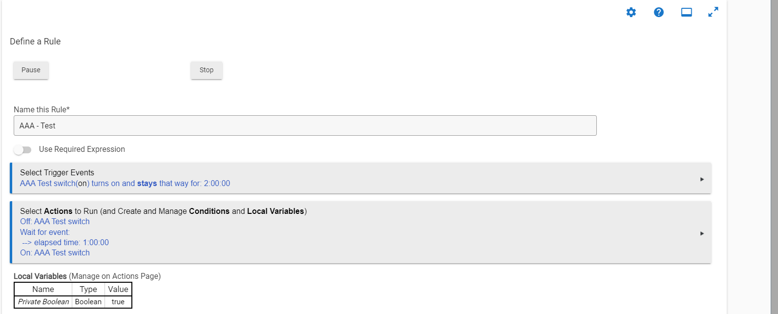

I would use RM. This simple rule would control the turning it on and off. Anytime it is turned on it would run for two hours and turn off for one hour, and then start again.
How you start and stop the pool should probably be another rule. On certain days at certain times, etc. If you make rules to turn it on or off when needed this rule will cycle it.

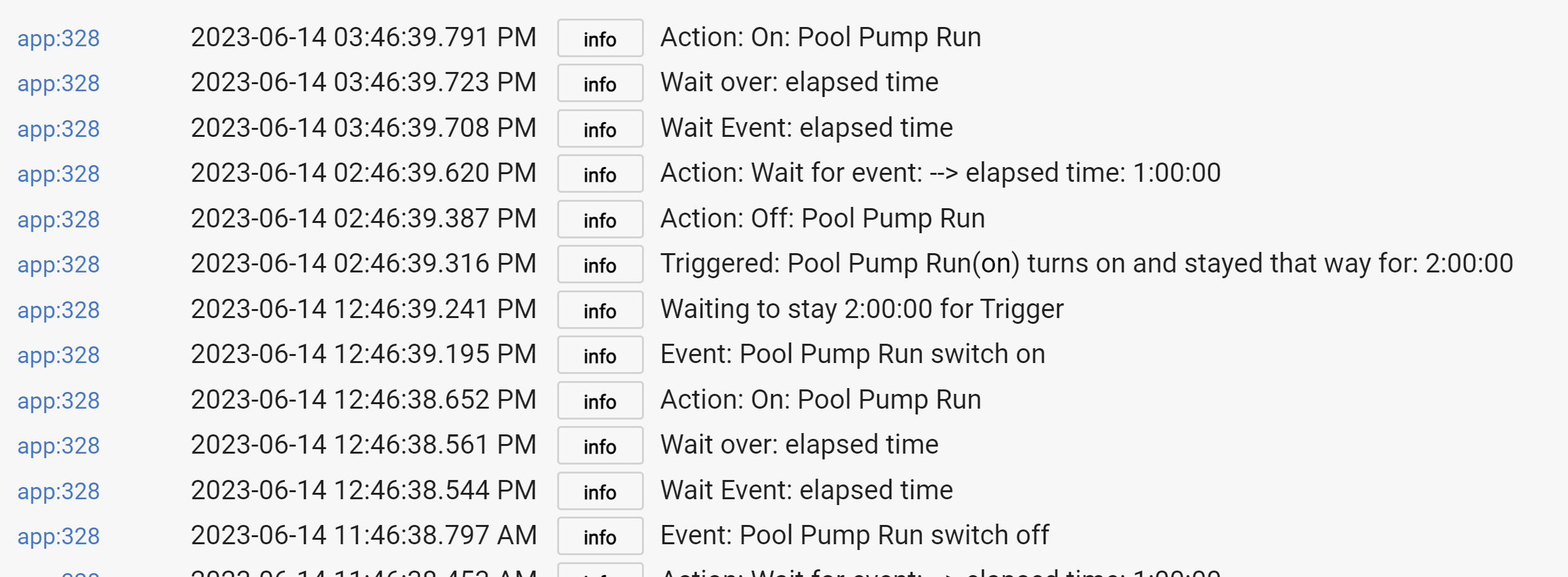

I tested this rule inside for a few days with some LED Lts. and it seemed to work fine. Hooked it up to the Pool Pump starter and it seemed to work OK but it randomly stops cycling. I don't see anything in the logs that gives me a clue what's going on.
Here's the log for the app, it should have shut off at 5:46pm but it's still running.
I can't seem to get it to run more than about 12 hours.

I can stop the pump manually. Stop the "Pool Pump beta" rule. Restart the rule and manually start the pump and it will cycle a seemingly random number of times. There are no other rules starting or stopping the pump.

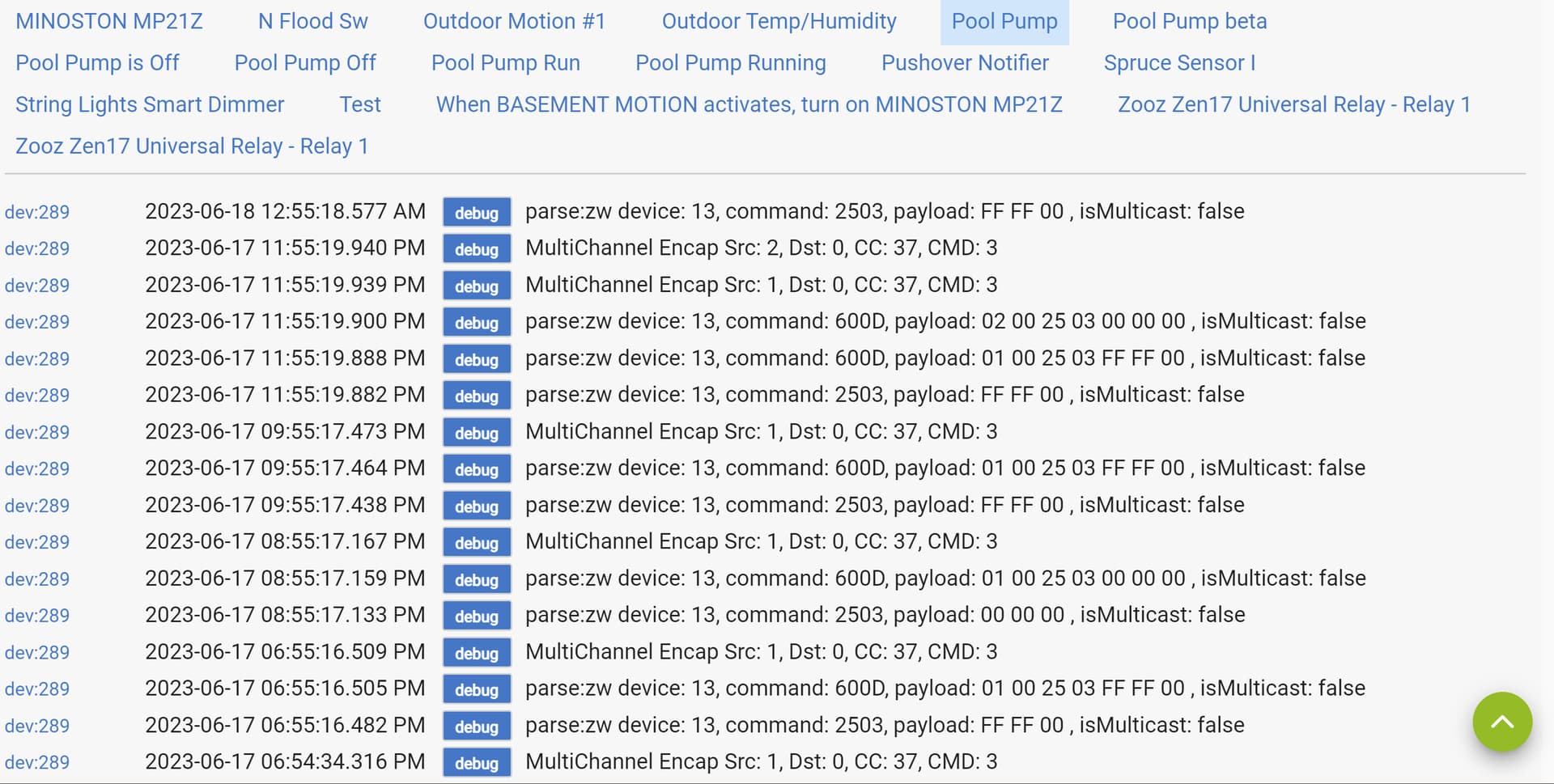

Here's the log from the relay.
This is from last night. At 12:55.18AM the pump was on but failed to turn off. I don't know what the debug "parse" lines mean but it always stops after the 2503 line.

This will repeat 10 times every 30 seconds, sending the command to turn the smartplug on if the power level does not go above 5 Watts. Once it exceeds 5 watts or loops the 10 times it will continue.
In your case you would just look at the relay and see if it responds that it is on or off. You can find this under repat options in RM, repeat while.

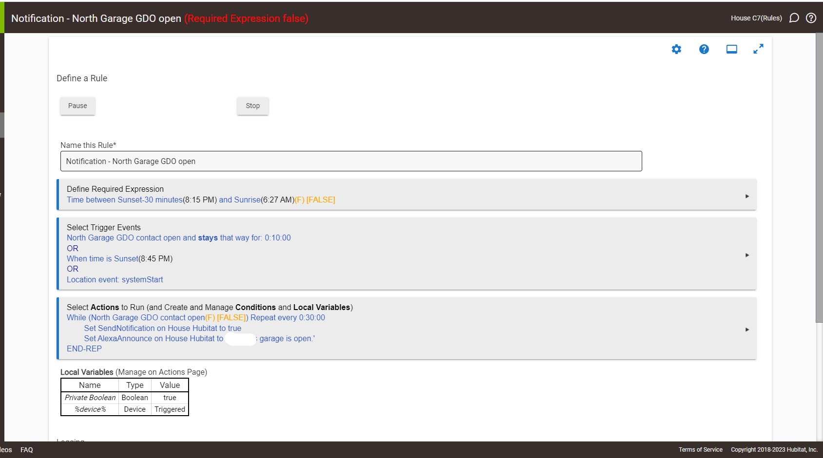

On another note, do you know a way to monitor or report the current state of a relay? I would like to close my garage door automatically if its open at 9pm but I haven't figured a way to monitor the tilt sensor. Here's my thread

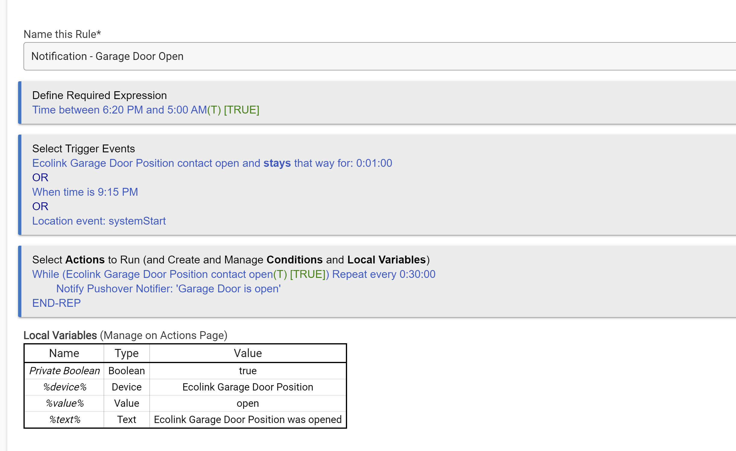

This is the rule I use for that.

Works OK if the Garage Door opens between the desired expression time but if the Garage door is open at 6:00pm then nothing happens at 6:21. I keep hearing that Hubitat is event driven, ie the contact needs to change state between the times but there's got to be a simple way to poll the switch and cause an "event"
I should have mentioned I only wanted mine to start sending notification after sunset.
If mine is opened and stays open outside of the required expression time then nothing happens. At sunset the rule is triggered and if the door is open it starts sending notifications.
If you want it to send notifications anytime the door opens and stays open then just remove the required expression and the time trigger.

If I deleted the required expression so the rule is triggered anytime the garage door is opened could I change the first OR statement to AND "When time is 9:15" Would this send the notifications only after 9:15?
Anytime the rule is triggered it sends notifications as long as the GDO is open.
The trigger determines when it runs. The required expression sets when a rule can trigger.
If you changed the OR to AND, then it would only trigger if the GDO had been open for the required time and it happens at 9:15. So you will probably never trigger the rule.
In my original rule it can only trigger from 30 minutes before sunset till sunrise. So if the door opens outside of that required expression time nothing happens. The rule can not trigger.
If for example, I opened the door at 3:00PM and left the door open and never closed it, then at sunset the rule gets triggered. It does not trigger because the door opened but because the trigger time of sunset occurred. It will trigger at sunset if the door is open or closed. If it is open it will start sending my notifications, if it is closed it does nothing. The GDO is closed so the while loop is false and the rule is exited.
The other trigger, systemstart, will occur anytime the hub is restarted. Again this trigger has nothing to do with the door, it is just a outlier case than could occur. If in my example above opening the door before sunset and leaving it open. If the hub for whatever reason was shutdown and not turned back on until after sunset I would get no notification the door was open. The door is already open and it is past sunset so neither of those two triggers can occur. The restart, however, will trigger the rule and if the door is open it will start sending notifications.
