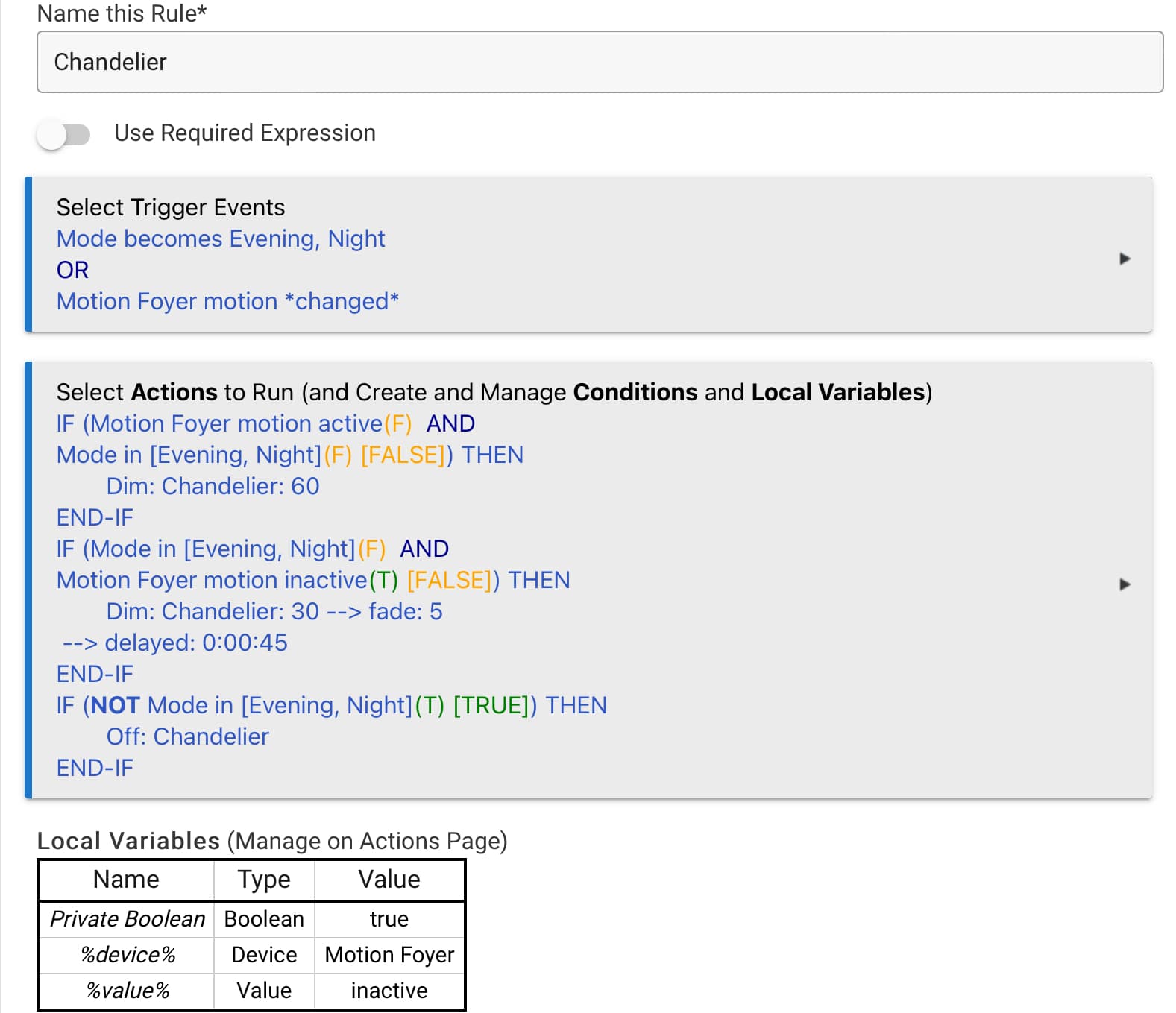

Please help me fix this motion rule
The logic for what I’m trying to do:
When the mode is evening or night, turn on chandelier at 30% brightness
When someone walks into the foyer (motion), increase brightness to 60%
When there is no motion for 45 seconds, dim to 30%
When mode is late night (after Night), turn off Chandelier.
Problem: The below rule I created for this seems to work most of the time. The motion sensor is a wired PIR device that instantaneously switches between active and inactive based on motion and has no built in delay before becoming inactive unlike some of my zigbee wireless sensors. The 45 second delay I added for dimming back to 30% works most of the time but once in a while I get an animated light show where the light continuously goes from 60% to 30% and back with no delay as I am moving in and out of motion sensor range.
I would appreciate any pointers on how I can fix this.
Your delay has no way to be cancelled. They function by using scheduled jobs. Once motion goes inactive, a job is scheduled for 45 second later to do the fade. As written, that will happen no matter if motion goes back active or not.
Simple solution would be to make the delay cancelable and add an action under your "motion active" section to "Cancel delayed actions."
An option to eliminate the light show is to add Cancel Delayed Actions as the first action and make your delayed Dim cancelable.
Question though, if there isn't motion what turns off the chandelier after Night mode?
Thank you so much for the response. I will try with Cancel Delayed Action. With my current logic I think the light show happens if I happen to be there at the end of 45 seconds. The light goes bright on motion but doesn’t wait 45 seconds any more to dim.
Great question on what turns off after Night mode. The lights have been turning off so I was assuming the logic worked but they probably turn off only because someone walks by after Night. I will test it by manually changing mode from Night to Late Night without motion.
