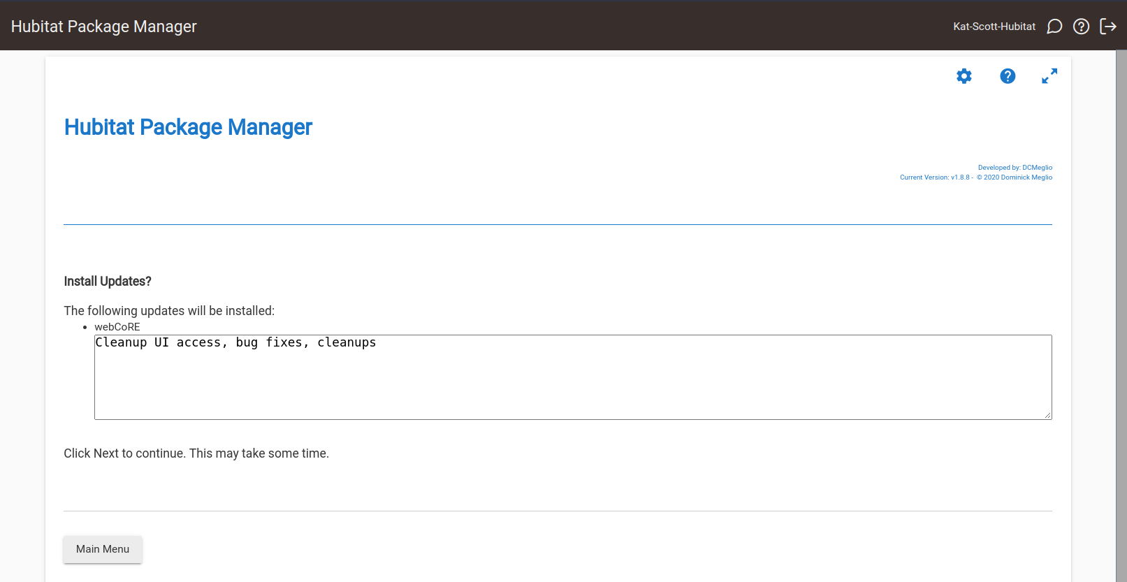

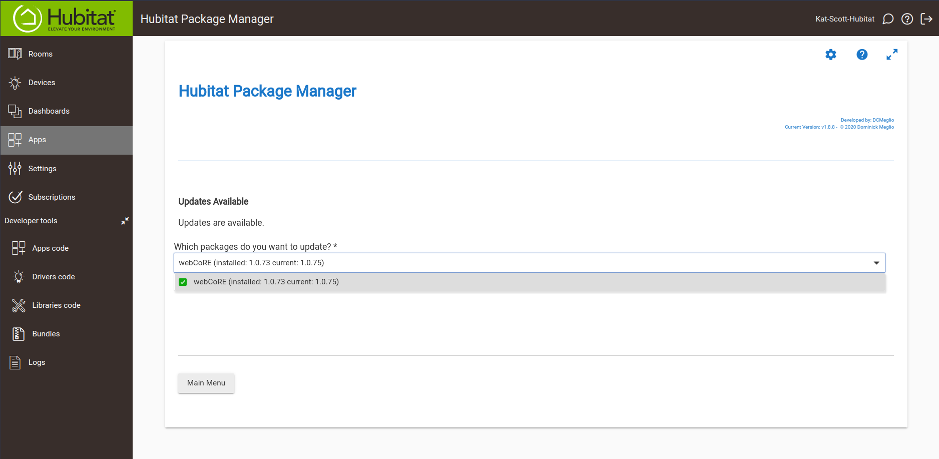

This morning on Platform Version 2.3.5.103 Hubitat Package Manager flagged available updates as is often the case. In checking for updates, it found an update for webCoRE 1.0.75
It proceeds to the next screen normally.

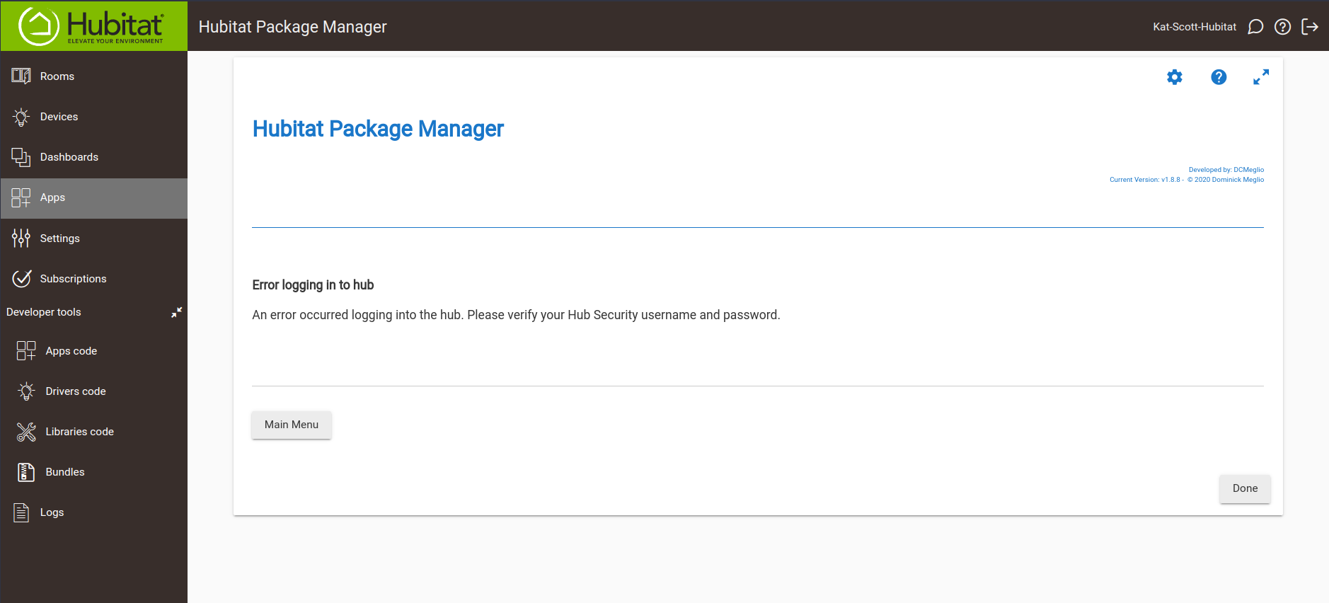

However, when I attempt to proceed from there.
I have logged out of the hub and back in and tried HPM again and the error is the same. Since HPM worked prior to 2.3.103, it may be that the error is specific to this update.
Did you enter your username and password into the HPM settings section?
@thebearmay I had forgotten that HPM has a password configuration. I remember now that I changed my Hub password two weeks ago. I hate when that happens. Thanks for the heads up!
