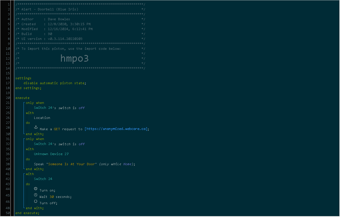

This piston is triggered via web request from Blue Iris. It triggers via local endpoint, but it does not perform the same way it does when tested using the "test' button below the piston. The logs show the same information when triggered via endpoint or when testing the piston via "test" button. What isn't working is that the http request isn't being seen by Blue Iris. The rest of the piston works just fine.
I also tried using a timer to run the piston every few minutes... just as a test. It works perfectly.
What am I missing? Why won't this piston run properly via local endpoint?

I don’t think I see any triggers here. What exactly is this piston supposed to do? What’s supposed to trigger it?
It's triggered via local endpoint. It's an http request that triggers it.
I have a bunch of similar pistons that work perfectly. There's one for the mailbox, one for the shed, and one for the gate. They all work essentially the same and I have no issues with any of those. It's just this one that's giving me problems.
It would be nice to see your trace of a call to this piston.

To the OP, can I assume that the web request on line 28 is a blue iris URL?
Do the other similar pistons you have also make a similar web request?
Without seeing logs, I’m wondering if you add a 1 or 2 second delay prior to turning on switch 24. Although it appears the piston is written to run synchronously, I’m wondering if the turn on command is negating the first condition under certain conditions. Quite unlikely, but something I would try anyway.
Also, do you need automatic piston state disabled? I don’t believe I’ve ever disabled that - are you trying to set piston states manually?
Finally, if line 38 is running, but line 28 is not, I would also try moving the web request into the same action list as line 38. You should be able to make a web request under Unknown Device 27’s action list.

To answer you questions... yes, the web request is to Blue Iris. Yes, I have other pistons that are almost identical that work perfectly. There's one that alerts if the gate or shed door open. There's one when mail arrives. They all use web requests to BI. I even trigger profile changes in BI using web request.
The only real difference with this piston is the type of camera it triggers. All of the others are Amcrest, and this one is a Reolink. Matter of fact, if I change the URL to trigger an Amcrest camera, it works perfectly.
