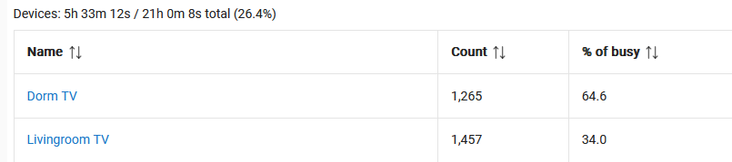

This works fine, but it causes high values in the Logs/Device stats page, probably because ping() is synchronous and the driver remains "active" while ping() executes.
Since "Livingroon TV" was on almost all day today, a lot less ping() were executed, hence the 34.0% vs 64.6%.
Despite the Device stats high values, I don't see any increase in the hub CPU usage. But it bothers me nevertheless :slight_smile:
