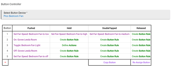

I recently added a pico to control one of these fans. Here is the button control for it:
Every button works...except Button 1 Pushed to set the Fan to Low.
I tried to assign Fan to Low to another button (and tried pushed, held, double tapped), no luck.
If I go into the Hubitat button rule "Select Actions for" page for Button 1 Pushed of the pico remote in question, I can push "run actions" and it will work. It just won't work if I push the button on the pico remote.

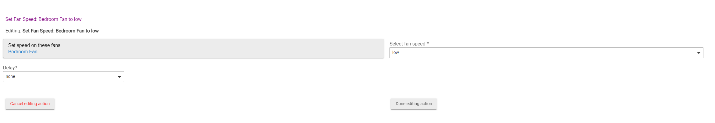

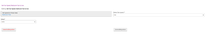

Once again, here are the button rules for the pico remote in question:
And here is the rule itself for Button 1 Push:
The logs showed that the other actions for button 1 worked (held and double tapped):
