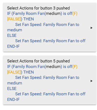

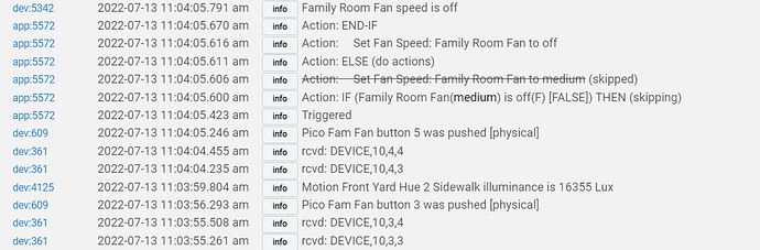

Button 3 and button 5 have the same logic in the Button Controller app:

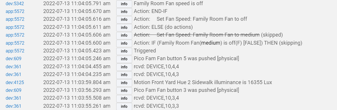

When I press button 3, nothing happens. Press button 5, and fan turns on/off as expected. The light on the Pico flashes normally when I press button 3. Button 5 triggers the logic/action normally in the logs, button 3 does not...there is no "Pico Fan Fam: button 3 pushed..." entry when button three is pressed

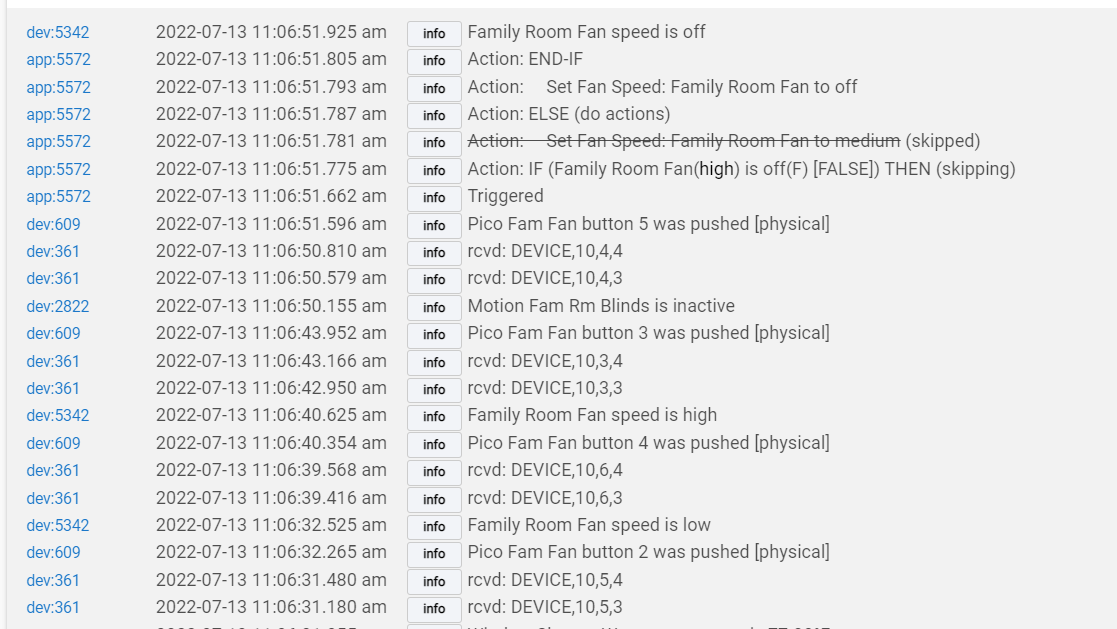

More logs of button presses from the Pico - button 2 and 4 work fine to set speed to Low and High:
Never had a Pico go south on me in this way - not sure why the button press registers in the logs but nothing happens...anyone seen this? I've tried removing the settings for button 3 completely and re-doing them, but same result.

It's just so weird that the button shows up in the box but doesn't kick off the logic attached to the button.

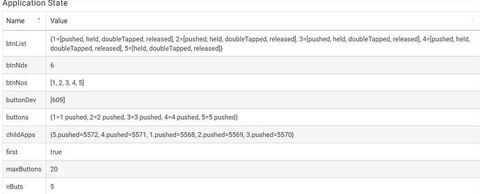

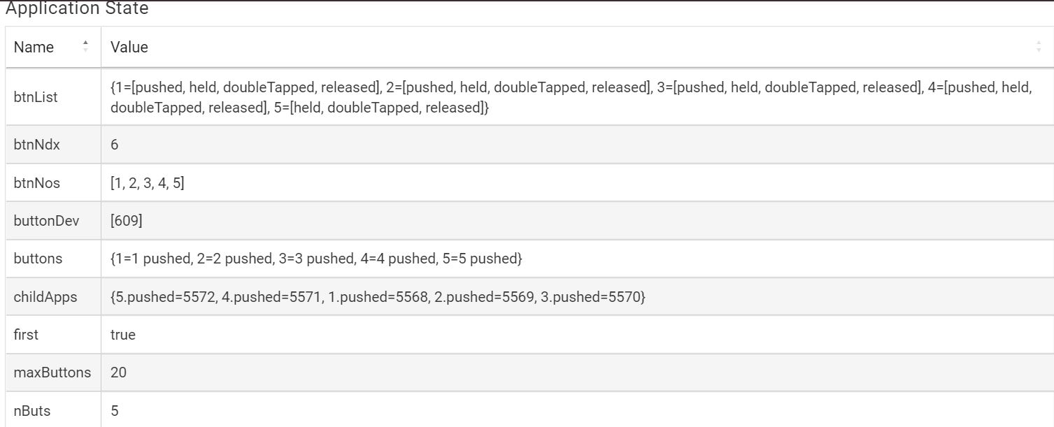

I assume you hit "Done" after doing this? (I think it's the grandchild app that matters, but the child can't hurt either.) Also, what do event subscriptions on the App Status page look like? I recall some issue with this a while back that was fixed, with the symptom appearing on this page ("null" where the number should be, maybe?).
In any case, this is definitely an app issue. Your Pico is doing what it should, according to the telnet logs. Just something in that Button Controller, it appears...
Thanks for the ideas.
Yup - I've "Donned" all the way out of the child and app, just to be sure.
Event Subscriptions and scheduled jobs are both empty.
2022-07-13 15_28_07-Chrome Main
2022-07-13 15_28_27-Chrome Main
Application state seems normal...
