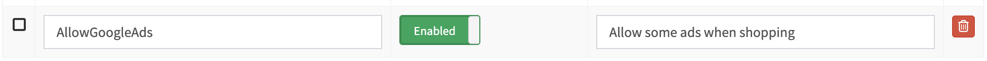

There isn't a unblocked group, per say. In my example, I'm thinking that I would "allow" the google ad domain for a specific group.
And assign the allowed rule to the group:

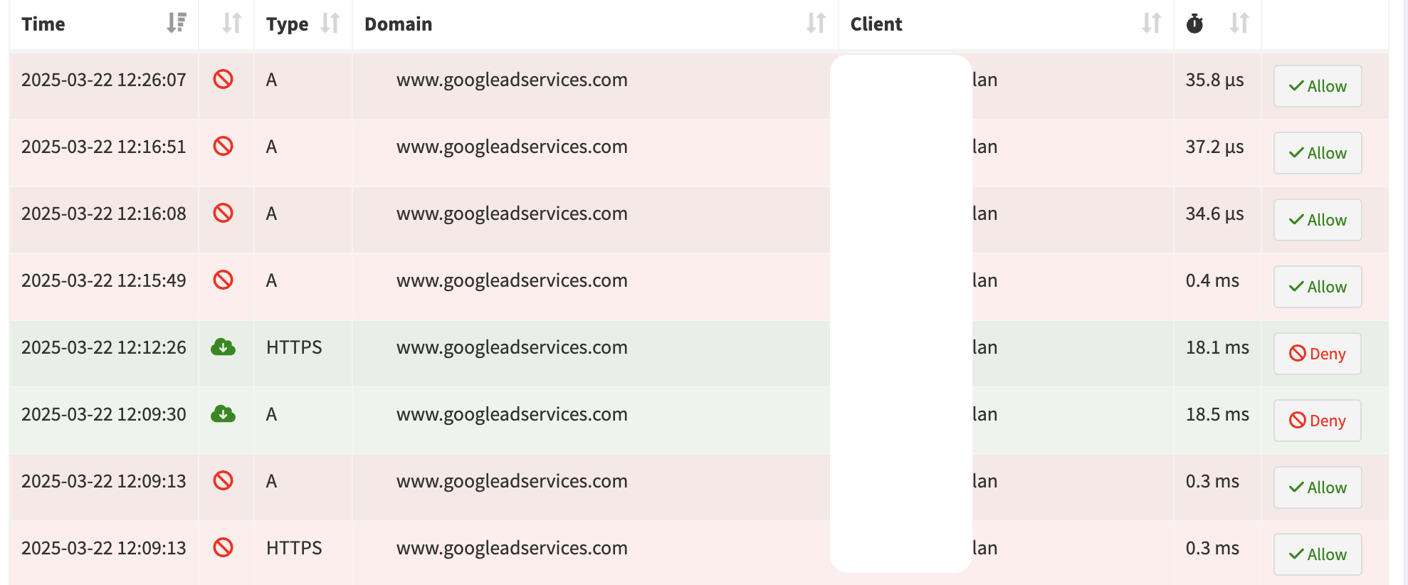

So this worked when I added my phone to the group. However, when I removed my phone (aka 2 minutes to quickly shop), I am still able to access those ad links. The domain is being cached (pihole and/or phone).
Before you attempt an implementation, I need to see if there is a way to set a short TTL for a specific domain. Pihole seems to have started blocking again once the device was removed from the group, but the phone is caching it, even though it was in a private Safari tab, tab was closed, and Safari quit and opened again, and a new search made.
There may need to be a logic to clear the caches whenever a group gets updated... and as I understand it, this could get expensive as part of the Pi-hole allure is local DNS caching so that you're not waiting on upstream DNS responses.
I agree, clearing the pihole cache would defeat the purpose of quick and local. Personally, I wouldn't mind the hit to clear the cache if that's what it took, as shopping is quite a rare occurrence.
The pihole cache doesn't seem to be the issue. Pihole blocks requests again when the device is removed from the group, as per my previous screen capture. There "appears" to be something on the phone/browser end. The domain is re-blocked by pihole, but the phone is still able to get around it. Three hours after removing and I can still click those ad links.
I'll keep testing. Again, thanks for considering this.
@walksonair Further testing has shown that the caching is on the device side, NOT pihole. I have found a solution to this caching issue. I have created a Shortcut which can flip a virtual HE switch, waits for 15 min, turn the switch off, wait 10 seconds and then clears the device's DNS cache (if macos: run 2 terminal commands, otherwise ios: turn on airplane mode, wait 10 seconds, turn off airplane mode).

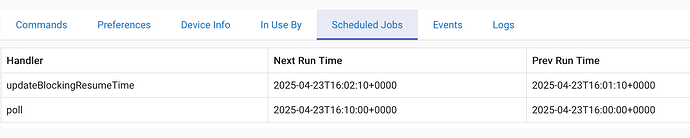

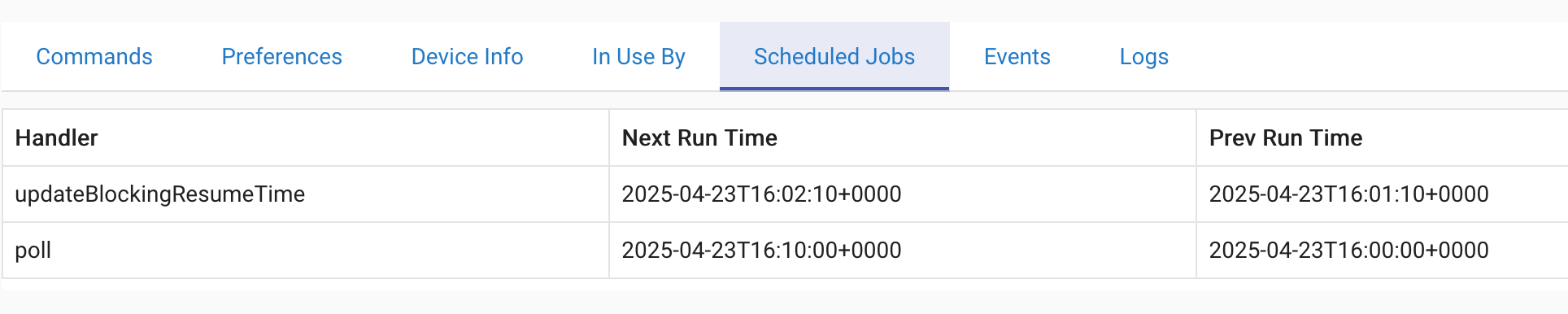

@walksonair - What does the updateBlockingResumeTime call do?
I have my polling set at 10min, but I'm seeing this scheduled for every minute or so, but I'm not sure what it is updating or why so often.
Not concerning, I just tend to scrutinize what events are triggering on my Hub given historical performance issues. lol
Hey there neighbor! Thanks for digging into the driver—knowing someone else is poking around actually makes me feel better.
The reason you’re seeing that “updateBlockingResumeTime” job fire every minute is because, whenever blocking is turned off, I schedule it to:
1. Refresh the “blockingWillResumeAt” timestamp in the UI so you always see an up-to-date resume time, and
2. Double-check the timer and immediately re-enable blocking the moment it expires.
I chose the every-minute approach because I was worried a single runIn(..., onResume) job might get lost if the Hub ever rebooted during the countdown. Do you happen to know whether Hubitat’s runIn schedules survive a reboot? Or—if you’ve got a more bulletproof pattern for this—I’d love to hear your recommendations!
Awesome.
I don't have a recommendation (will think about that), but I think I might be hitting a bug then, I see that updateBlockingResumeTime running even when I'm in normal 'blocking' is on mode, which is what I wasn't expecting. And it sounds like it should only be running when in blocking is off. For example I've been in blocking is on mode for the last 5+ hours but still seeing that every minute.
Does that make sense?
I think you may be missing a:
unschedule("updateBlockingResumeTime") somewhere in around line 215?
Or perhaps instead of using runEvery1Min, you could just run once and check before rescheduling like you are doing with polling instead of a runevery10
