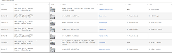

Currently, 0F (Front Door Lights) is dead, and i dont know which breaker it is. SIgh.

Power fluctuations may be a thing, but I would hope my computer would crap out first. Theres just no way i could tell. Seems like it shouldn't be a thing though. Especially across brands.
Unknown on the firmware revision of my Zooz switches, not sure how to check, or even update within HE...

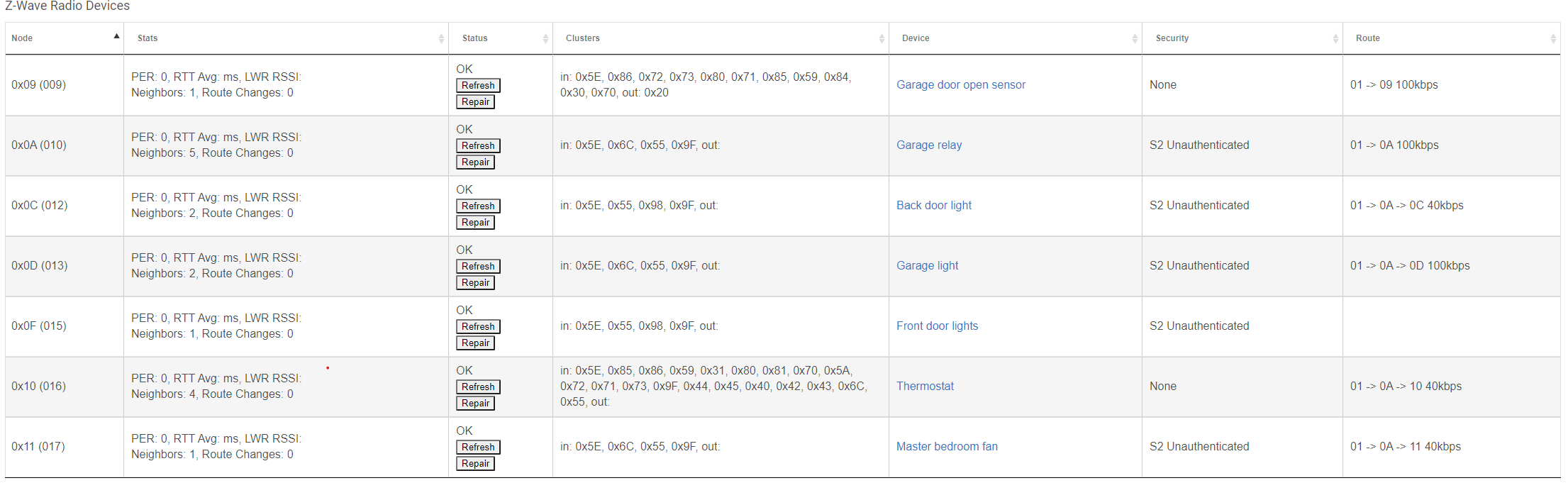

Garage light crapped out again. thats my 3rd light this month.
