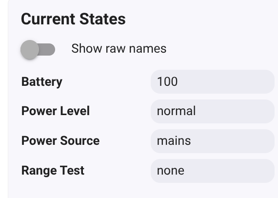

If you are looking for a loss of power notification the Ring z-wave extender works. It plugs in but has a built-in battery. Notifies on AC power loss and can be used in a rule to change mode. It connects directly to Hubitat without a Ring hub. https://www.lowes.com/pd/Ring-Alarm-Z-Wave-Range-Extender-2nd-Gen/1002751870
