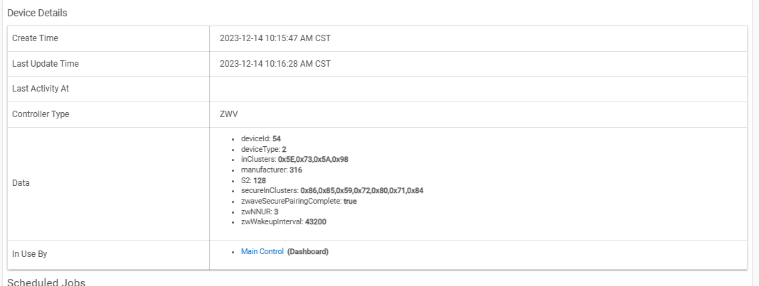

I see this driver mentioned in a couple posts but I cant find it grrrr. is it in built in apps or perhaps the HPM application I just learned about>
how do I install that driver if you have time to explain and where from?
I dont have any open or closed information in that screenshot is where I see that?

This is built-in. You do not need to install anything. Look also for "Generic Z-Wave Contact Sensor" (actually can't remember if the Plus one exists, but for your device I'd use it if it does).
The driver is the "Type" dropdown on the device detail page if you are not aware.
