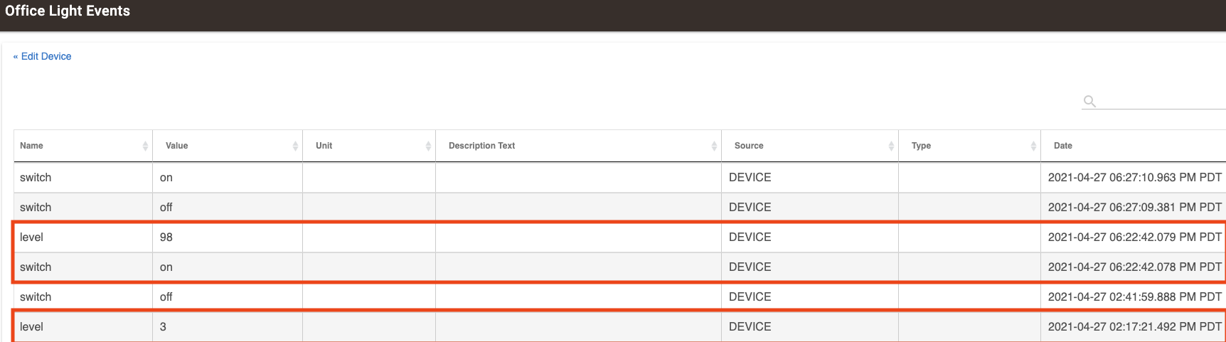

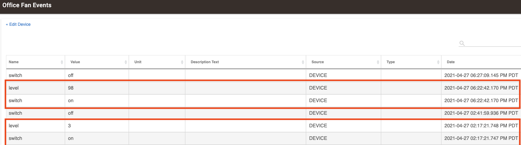

Well it just stated happening on another LZW36. I see events on the devices that all show up at the exact same time setting level.
The debug logs from Maker API (how I have Home Assistant integrated) I see the following:
[app:2](http://hubitat-c7/logs#pastapp2)2021-04-27 06:22:42.230 pm [debug](http://hubitat-c7/installedapp/configure/2)device event: {"name":"switch","value":"on","displayName":"Office Fan","deviceId":"42","descriptionText":null,"unit":null,"type":null,"data":null}
[app:2](http://hubitat-c7/logs#pastapp2)2021-04-27 06:22:42.226 pm [debug](http://hubitat-c7/installedapp/configure/2)device event: {"name":"level","value":"98","displayName":"Office Fan","deviceId":"42","descriptionText":null,"unit":null,"type":null,"data":null}
[app:2](http://hubitat-c7/logs#pastapp2)2021-04-27 06:22:42.130 pm [debug](http://hubitat-c7/installedapp/configure/2)device event: {"name":"switch","value":"on","displayName":"Office Light","deviceId":"41","descriptionText":null,"unit":null,"type":null,"data":null}
[app:2](http://hubitat-c7/logs#pastapp2)2021-04-27 06:22:42.125 pm [debug](http://hubitat-c7/installedapp/configure/2)device event: {"name":"level","value":"98","displayName":"Office Light","deviceId":"41","descriptionText":null,"unit":null,"type":null,"data":null}
