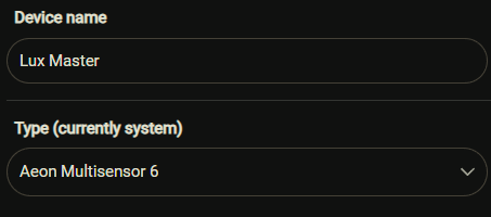

I always get this twice on a Config command using the the built-in driver. under JS.
groovy.lang.MissingMethodException: No signature of method: static com.hubitat.helper.HexUtils2.integerToHexString() is applicable for argument types: (null, java.lang.Integer) values: [null, 1] Possible solutions: integerToHexString(int, int) on line 124 (method parse)
dev:1612025-09-06 09:00:09.712
error
configure...
