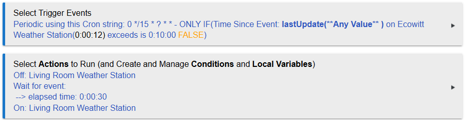

I have a weather station that locks up and needs to be rebooted occasionally. I have the outlet switch set up and I can manually reboot the weather station as needed. However, I really want it automated. I set up a rule with a periodic trigger and selected 0, 15, 30, 45 assuming that's what would run it every 15 minutes with a condition that it hasn't updated in the last 10 minutes, but it never triggered. Then, based on some documentation I stumbled across, I changed it to a Cron string, and it still won't fire. Here is what it looks like now:
When I notice the weather station has locked up, I look and I can see the condition is true so the rule should be firing to restart but it never does.
Any ideas what I'm doing wrong or another approach to rebooting my weather station?

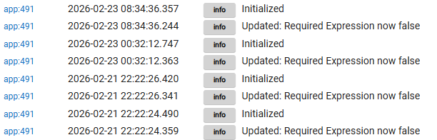

This is what the rule log shows:
The device only shows events where I have manually turned it off and back on again.
What is the rule's Required Expression? It's evaluating as False, so the rule will never run.

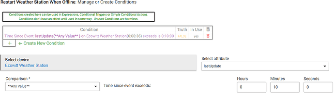

This is what the condition looks like:
It does evaluate to true when the weather station locks up and stops reporting.
It would be helpful to see the log when the required expression is true.
That condition is clearly currently being used specifically as a conditional for the Trigger, but did you (at some point) have that same conditional as a Required Expression for the rule?
Edit to add... Anyway, the point is that your rule thinks there is a Required Expression in play and it thinks it's False... There's a (hopefully rare) bug some of us have noticed lately where an old (but no longer used) Reqd Expression continues to haunt a rule -- I'm wondering if that's what's happening here too.

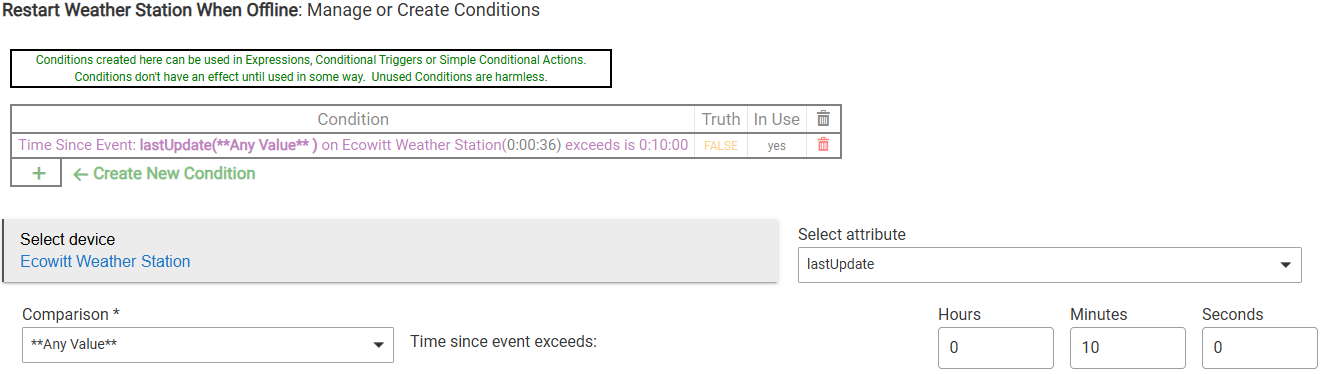

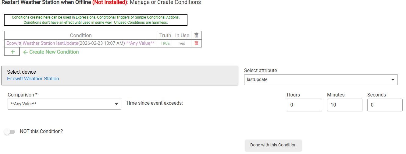

I deleted the rule and rebooted for good measure. Now I'm trying to recreate the rule. I set up the periodic trigger but the condition won't re-create the way it was before. This is how I had it set up before and it evaluated to false as long as updates were happening and then it would evaluate true when the station stopped responding:
Now I can't get it to do what I had before. Maybe I'm taking the completely wrong approach.
I want a rule that detects when the weather station has not updated for ten minutes, turn it off and then back on again.
I'm obviously doing something wrong but I don't know what.
