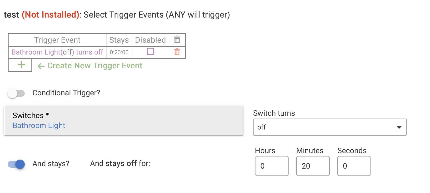

Is this what you are looking for? A trigger for a switch being off for a period of time (20mins) w/o having to poll. This is how I would do that in RM.
That is very close I believe the rule can only be used as part of an on/off trigger and not as a conditional statement, which was my issue.
I guess could probably do something using either more virtual switches or a boolean, many thanks it has clarified why I couldn't find the 'and stays' parameter.
